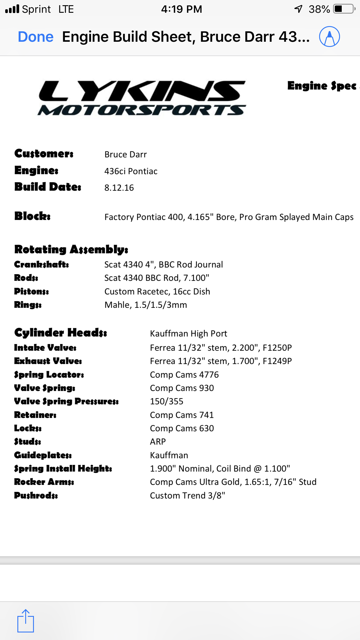

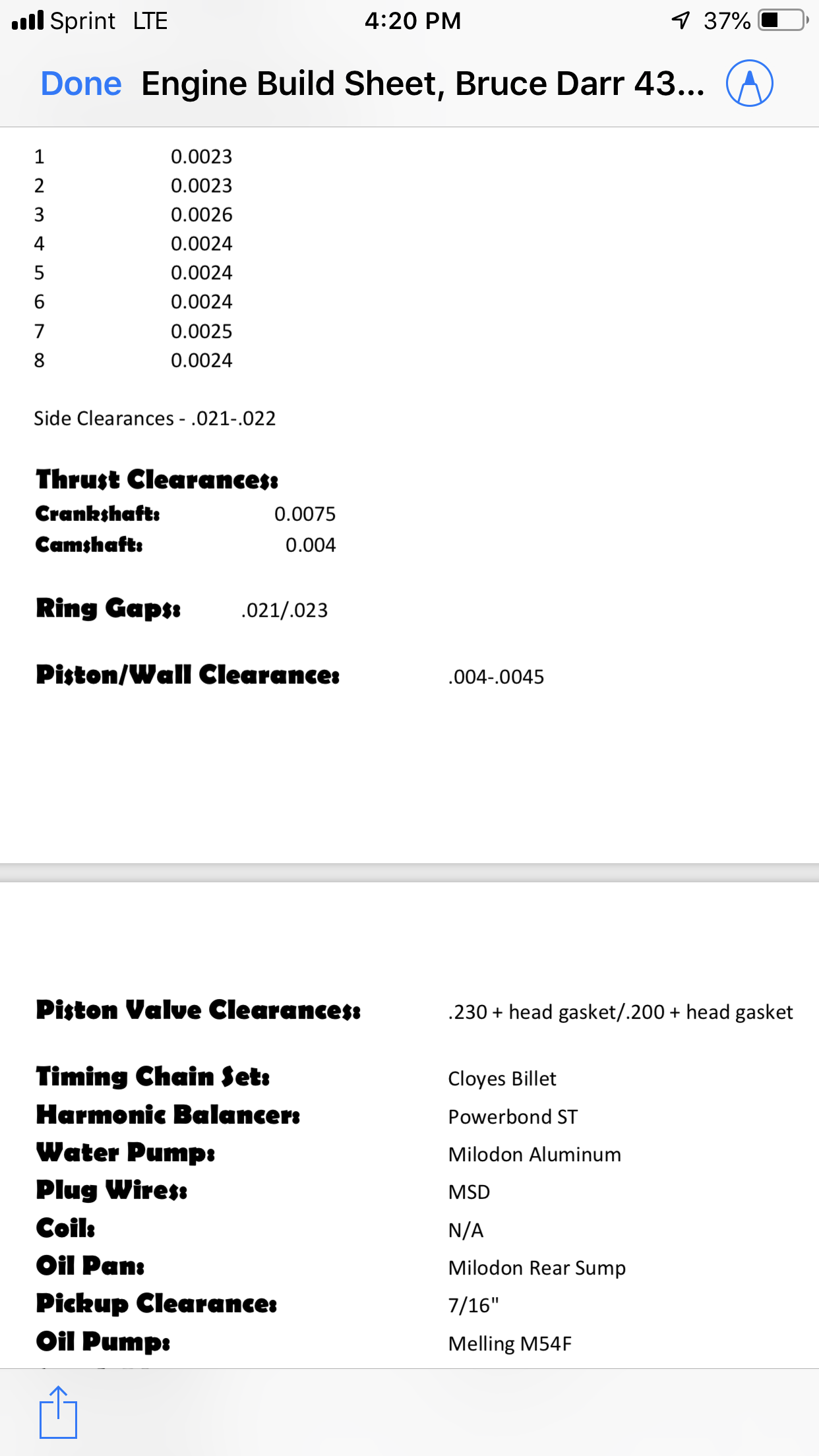

Wow nice car and build. Those heads flow awesome according to their numbers.
Very nice.
