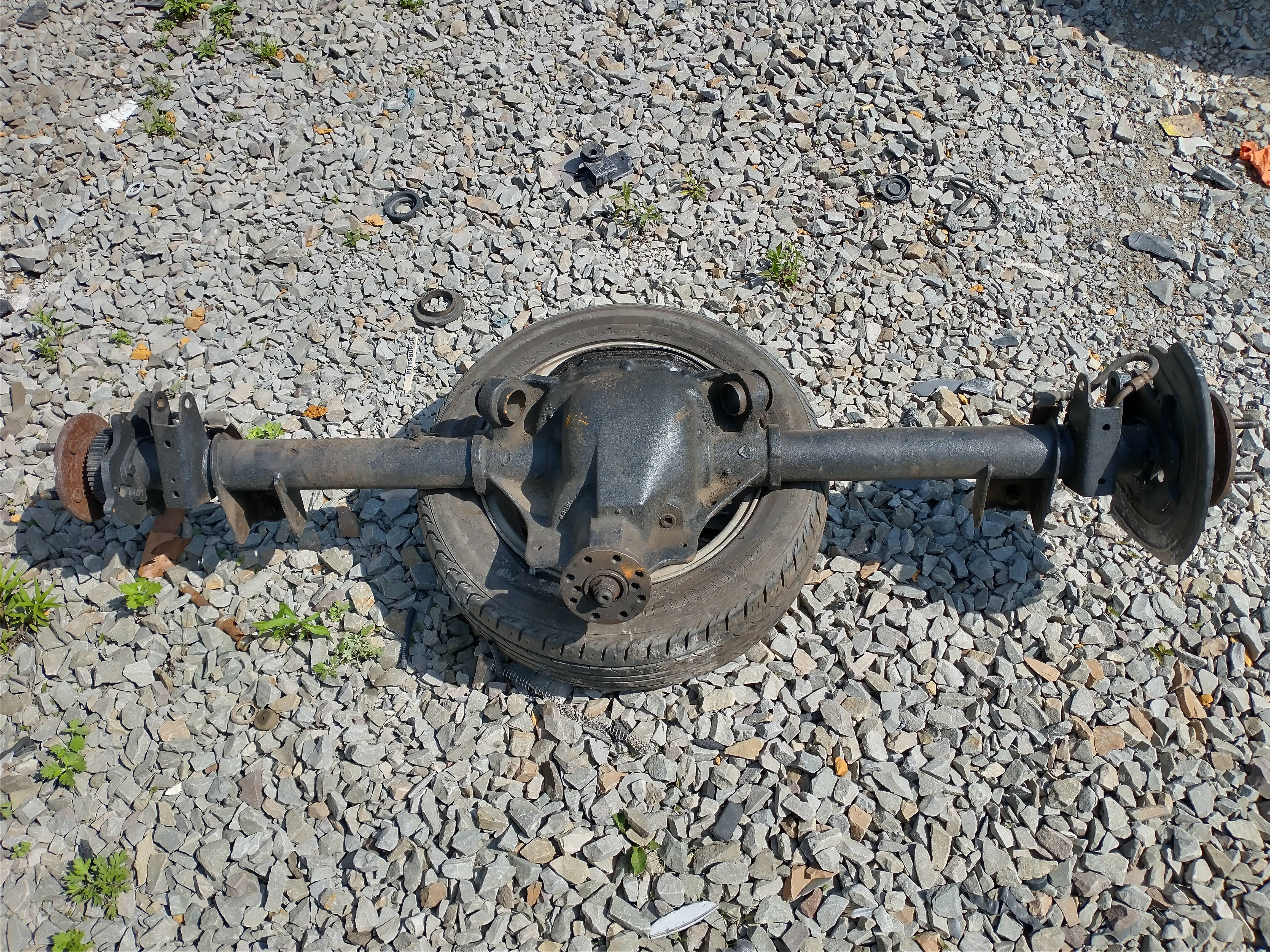

Think I found one, someone already robbed the brakes off of it. I probably would've replaced that anyways for piece of mind. Got there way to late to get it out, they were closing.
They do have a complete one still on a car, I would have to remove it. But it has rust all over it.
I really like that this one has very little surface rust. If I going to buy brakes for it, what upgrades can I do if I'm buying it from scratch? See some guys go with cobra brakes or something better than stock. For what I want to do with it, I think stock will be ok. Just don't know if there is better for not a lot more than stock.

Depending how they price em, if there's no discount for the brakes missing grab the brakes off the rusty one and loosely attach em. Then youve got core parts and can see how it all goes together.
Depending on your plan for using as is ot rebuilding, could compare gear ratios and do the same, just loosely swap the parts and worry about correct settings at home if the rusty rear has a more favorable ratio.....
They are the same ratio. Can walk out with the rear for like $120.
