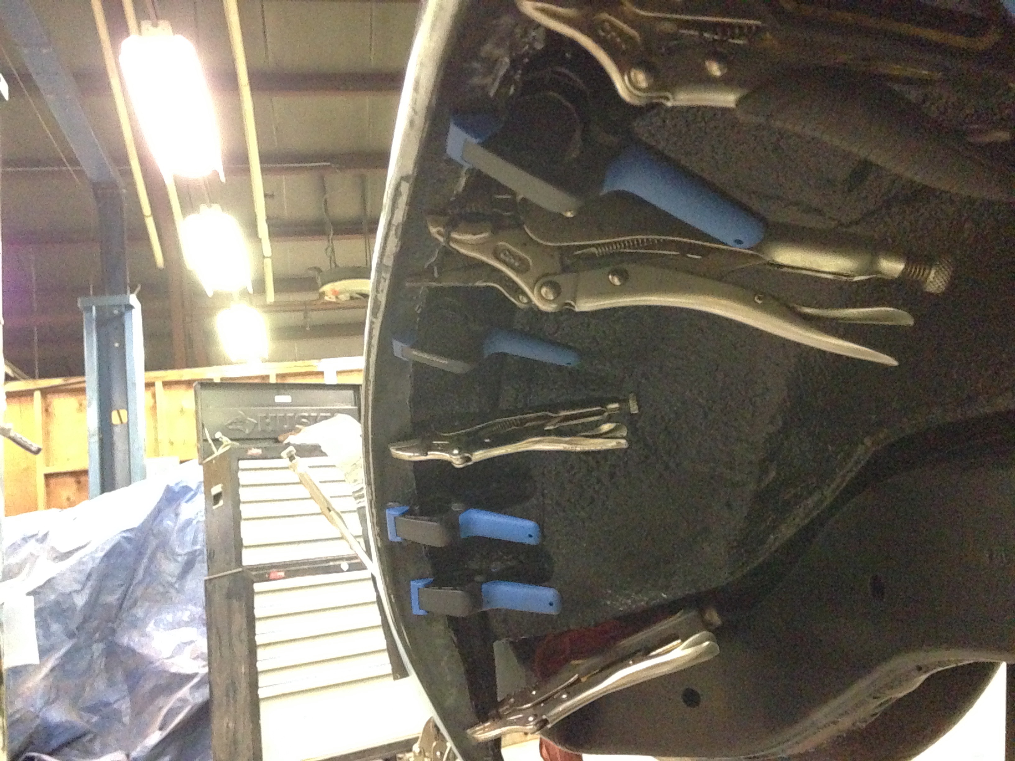

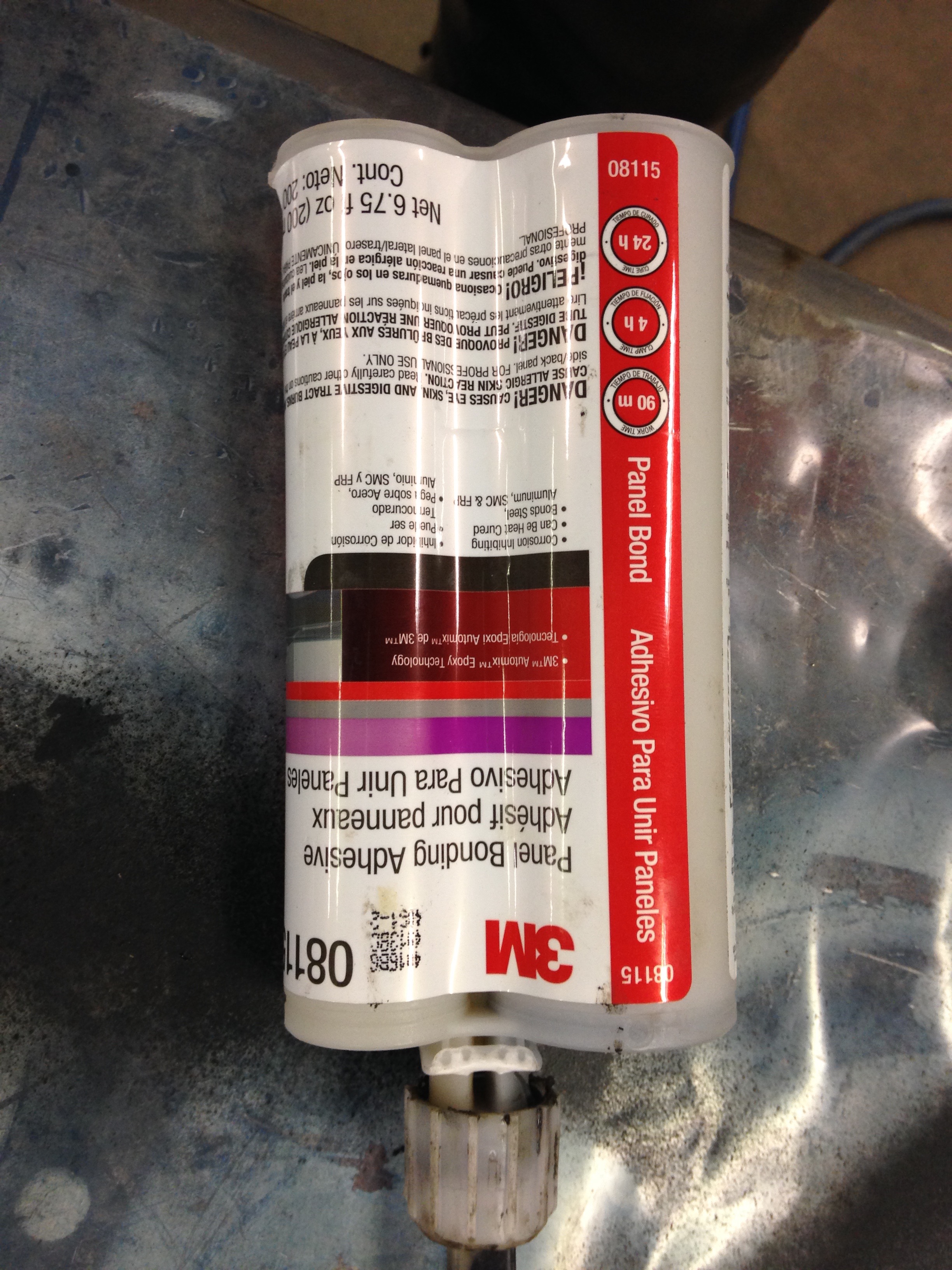

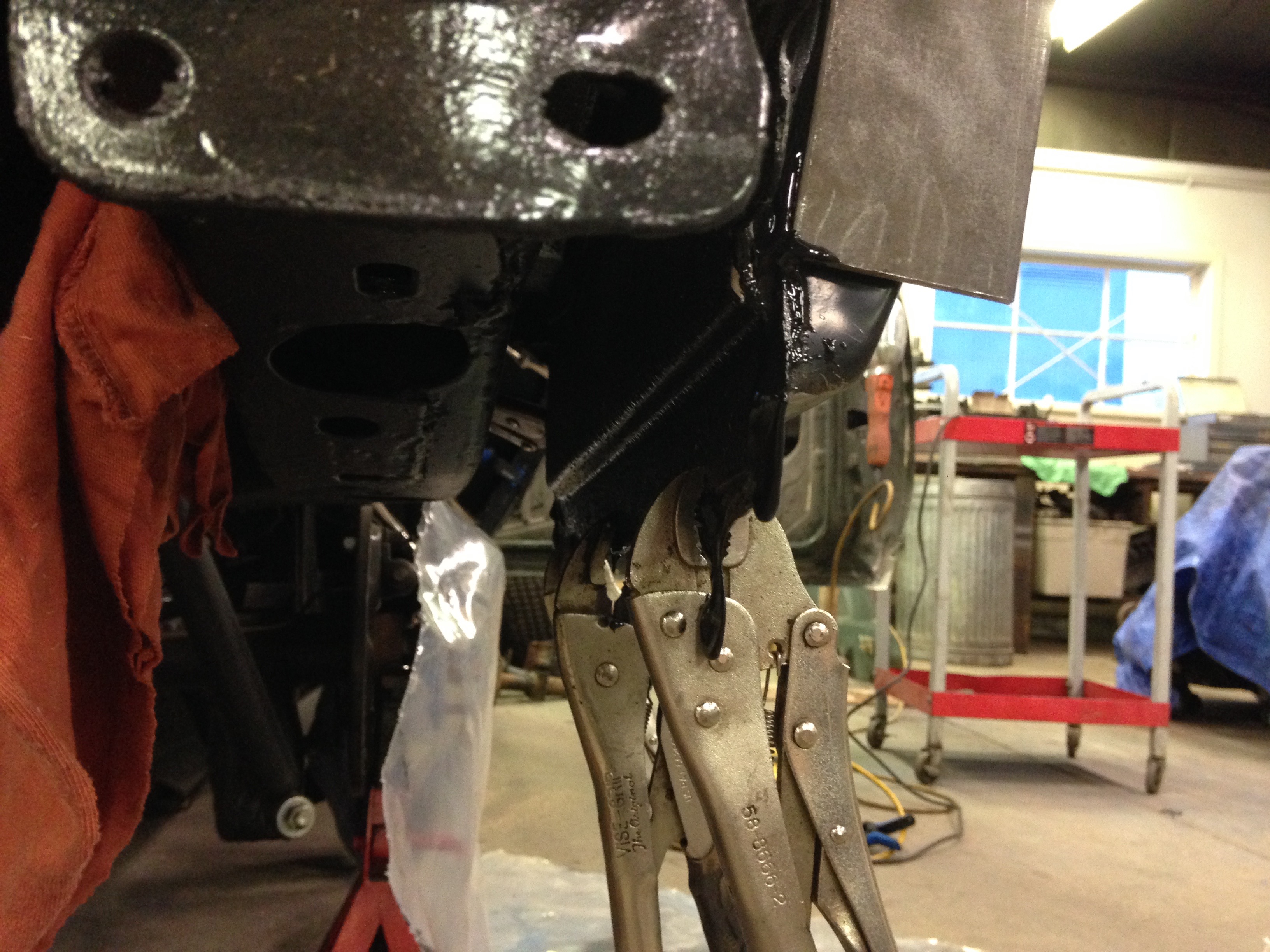

Back at it today, and I made some big progress. I first cleaned up all the oozed out panel bond around the wheel well, it looks like it turned out pretty damn good. The only downside is that you won't be able to roll the fenders cause the stuff is hard as a rock.

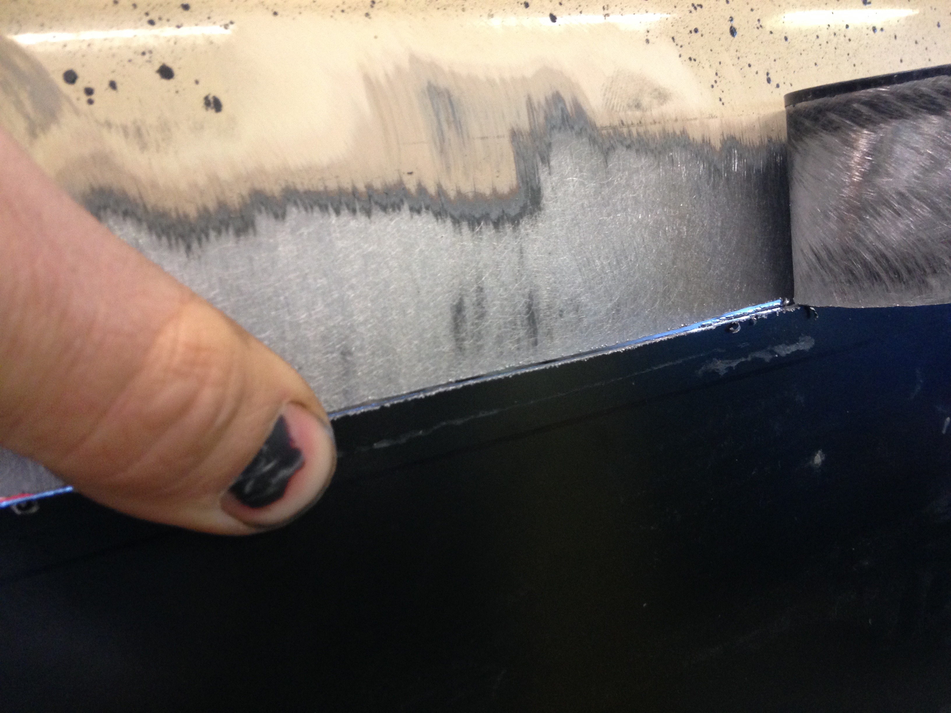

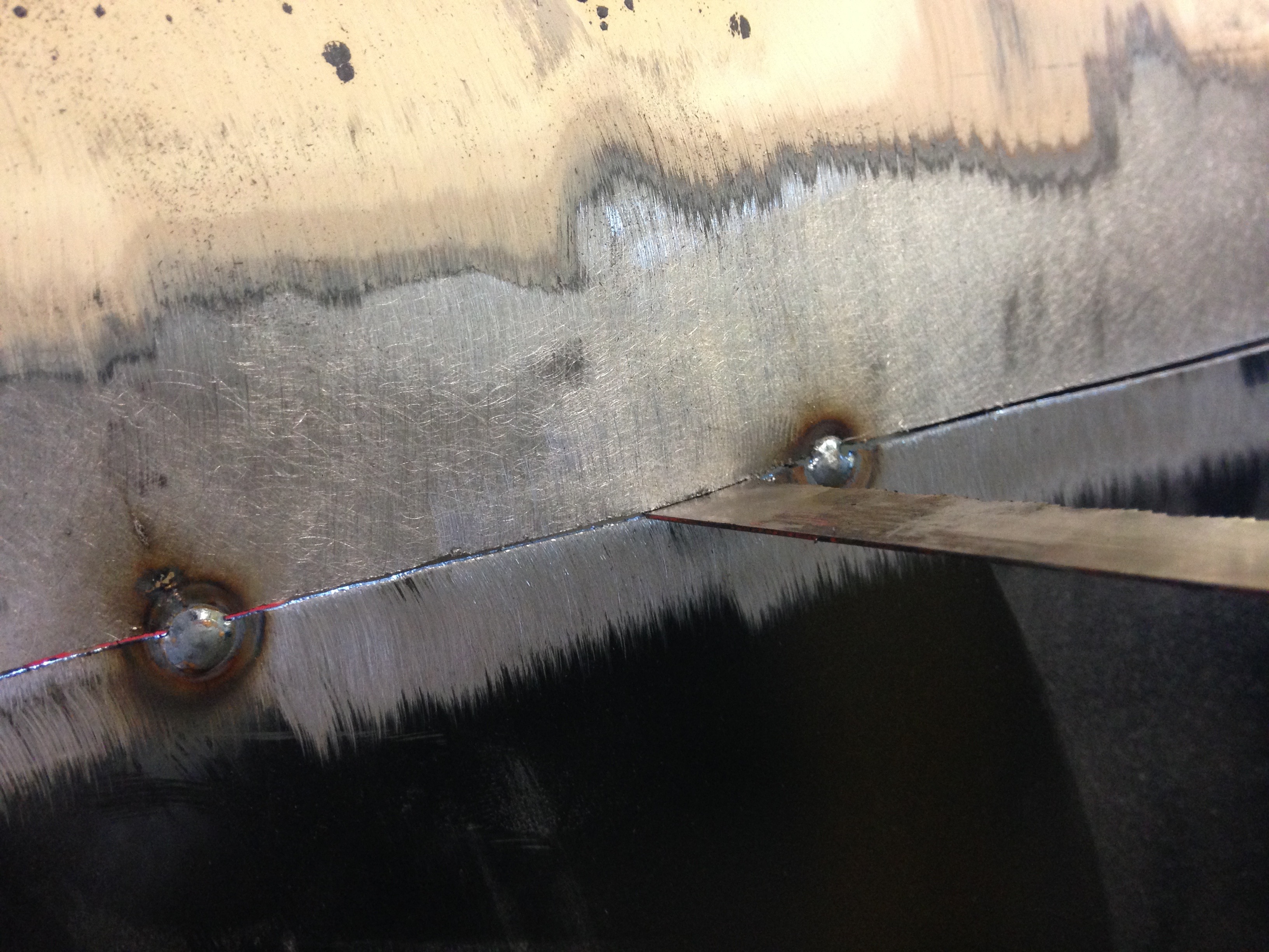

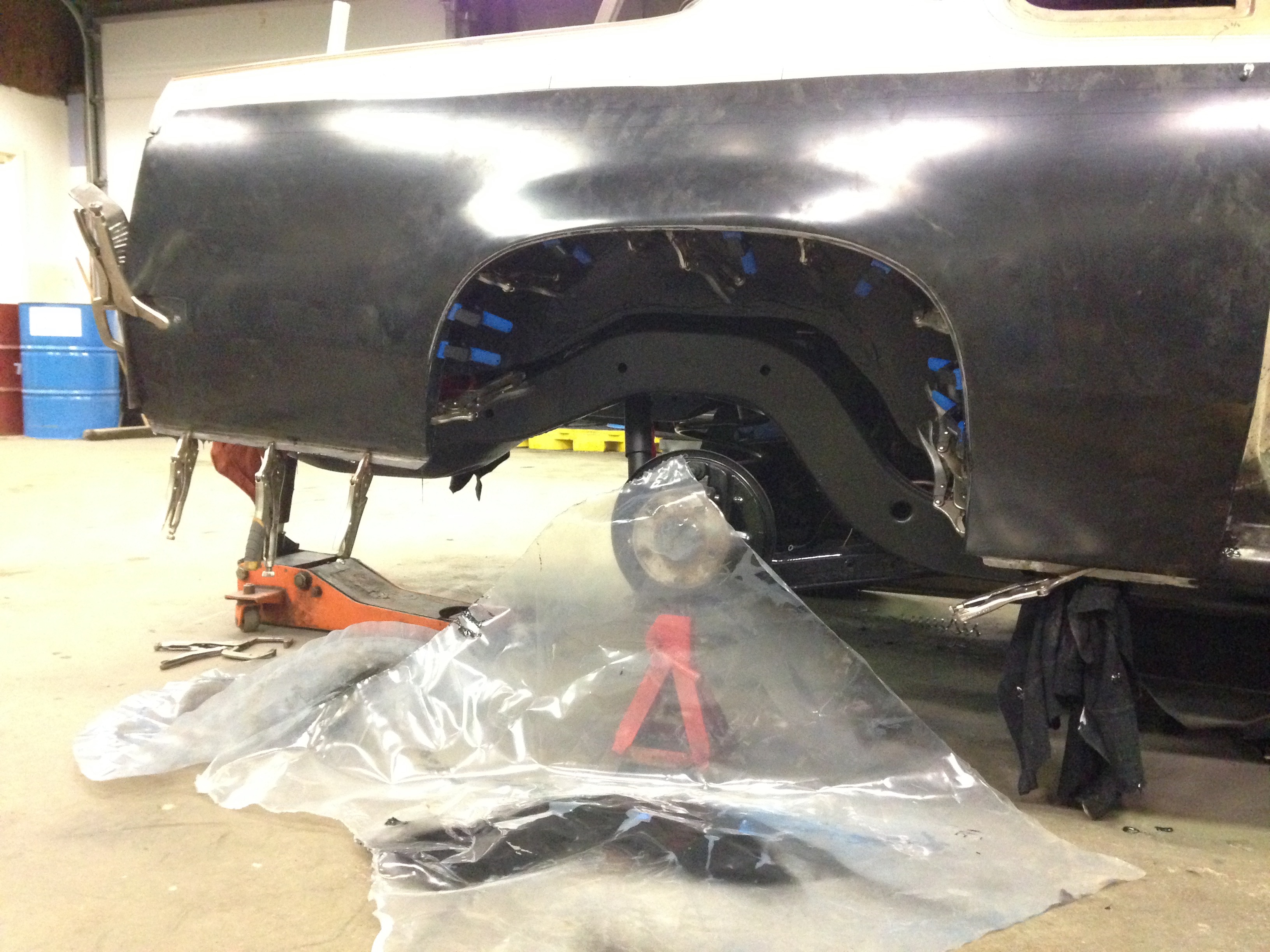

After cleaning up all the squeeze out I started to prepare the two panels to get welded together. I basically just ran an air saw through the new panel and old quarter. Peeled the off cuts back and then tacked the two together. I used a piece of hack saw blade between the panels to keep them from pulling together and warping. It seamed to work great, after about 20 tack welds the panel was stiff enough that it wasn't shrinking at the welds and warping.

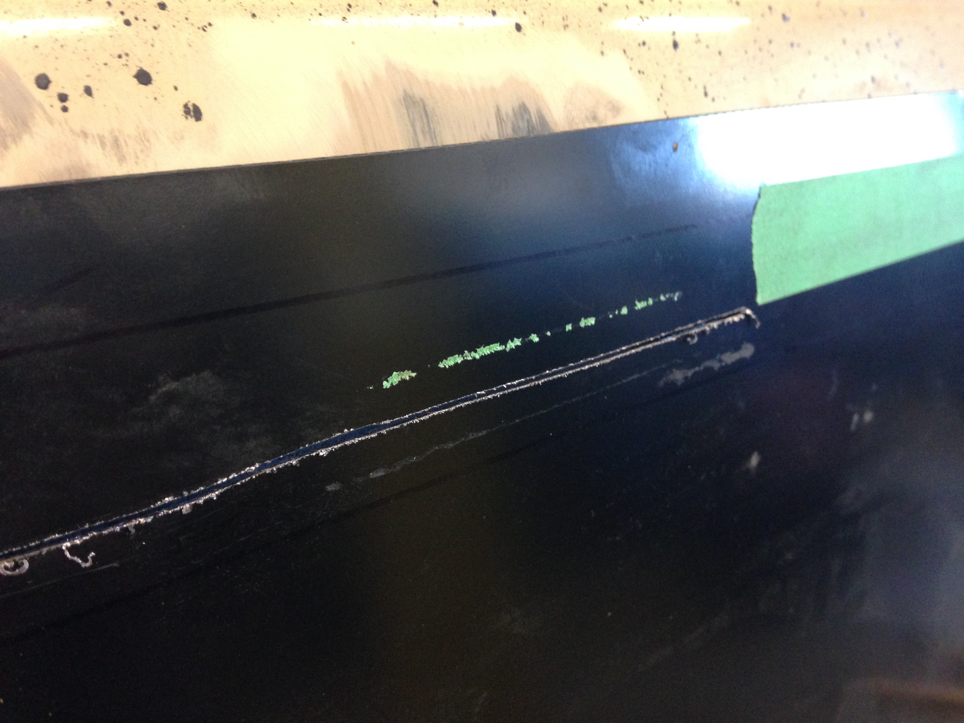

after a couple of hours It was finally one piece again.
You can see in the reflection of the bench she has a bit of cellulite in her hips but nothin we can't smooth out.

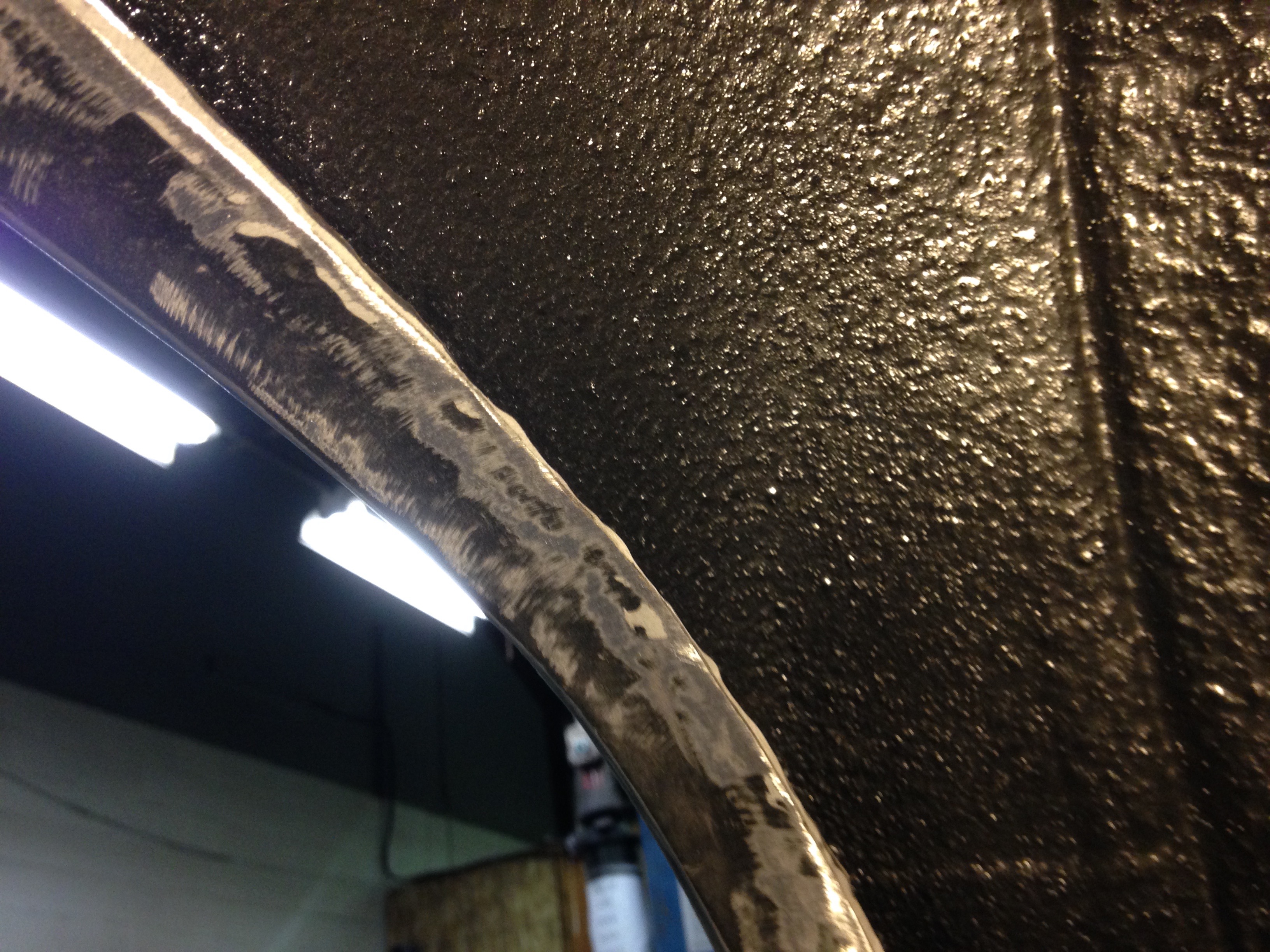

After a few hours with the hammer and DA, the panel came out awesome. Not quite a fillerless joint but if you shoot for the stars you'll land on the moon.
