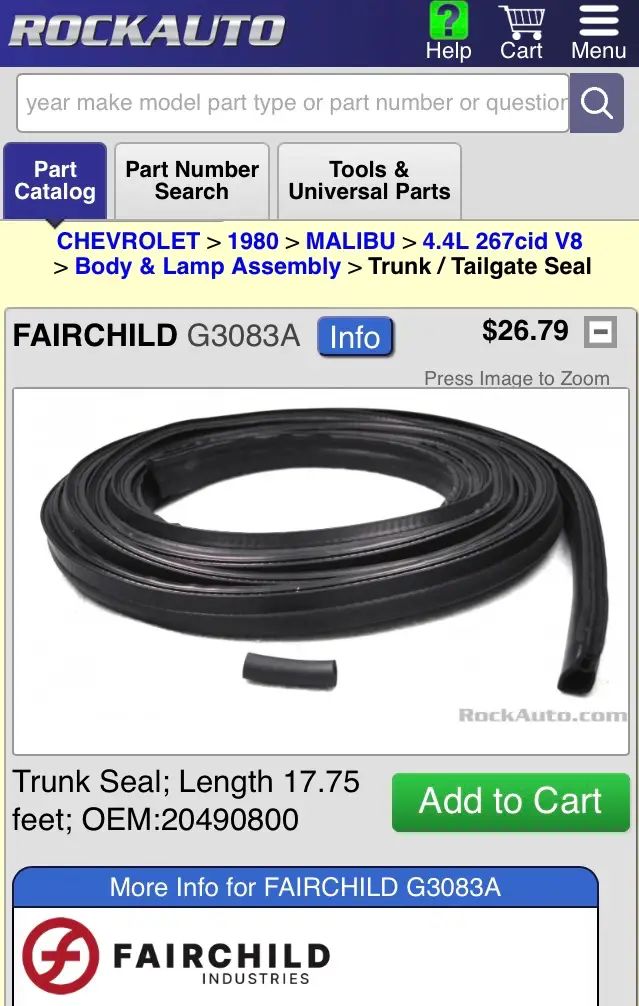

Going to take the old power steering box in next week to get rebuilt, the parts wagons one is a sloppy old dog. Even adjusting it didn't really help but $600 to get her original fully rebuilt will solve that problem, id say apart from that there will be a lot of sanding in my future haha. A question to? Can you get new rear cargo glass seals for these, ones in the back of this are hard & pretty crusty. Cheers all 👌 😎

Trunk weatherstrip from a G-body sedan or coupe will work. It lacks the flared ends that the wagon used, but that's not needed. Just cut to fit.
