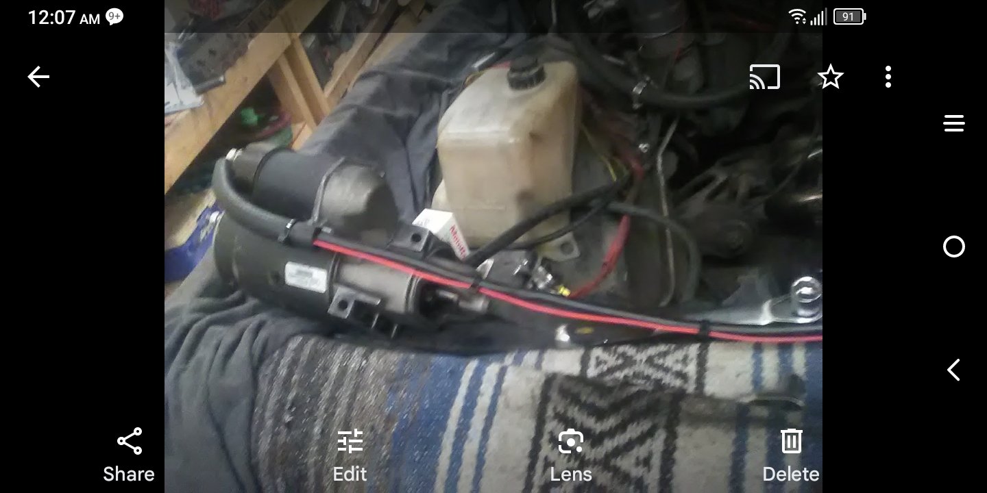

Picture of 87 Caprice Street/Show starter setup. Quick disconnect is out of frame. I used a piece of new clean 3/8 Fuel Line as protection for the wires. The disconnect was mounted in junction box on passenger firewall. Heat Blanket was not mounted yet, but once it is, to change starter, disconnect main cable, disconnect solenoid quick disconnect and remove bolts..., drop out starter.
