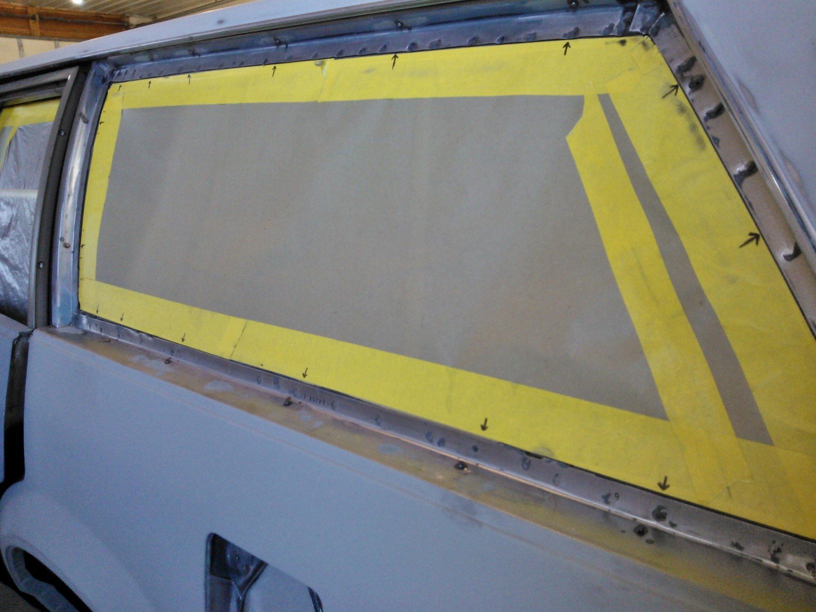

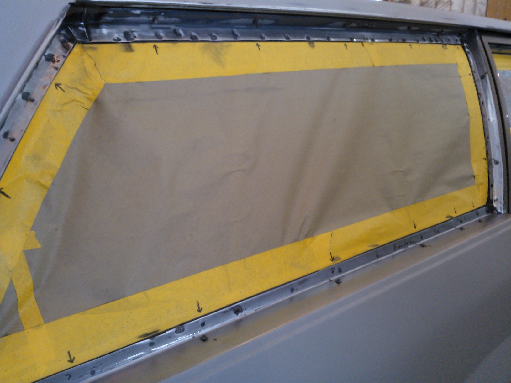

Got my studs for the trim clips all welded in place yesterday.
Went pretty smooth except for me burning thru the metal in a few spots from the ground ring on the uni-spotter... 😱
Given their locations, a quick little wipe of duraglass will make them go away.
View attachment 38028 View attachment 38029

I had the same issue. I also had to redo a few because I held the unispotter there too long. The back lower corners were impossible to get to, I could only get so far down on he D pillar. Looks good, the aluminum trim is so much better.
