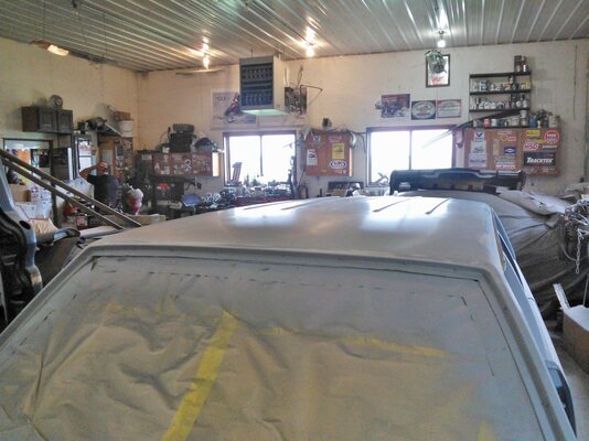

Instead I sanded out the ribs on the roof, since I had been putting it off for a while now...
Today I did some more sanding along the perimeter of the roof and hit a few spots that I had overlooked before.
Once I was satisfied with that I gave the whole roof a quick pass with 320 and cleaned it up to inspect my work.
All in all, I'm happy with it.
There's still a bit of a dip around the C-pillar area in all 5 ribs that just wasn't worth my time.
Realistically it's not that bad... though it will probably bug me, but **** it. I'm so over dealing with the roof I don't even care anymore.
The rest of it turned out really nice, so I'm calling it a draw!
It's tough to get a really good look at it in the picture, but it's not hard to see the difference if you look back at how it looked after the storm!
