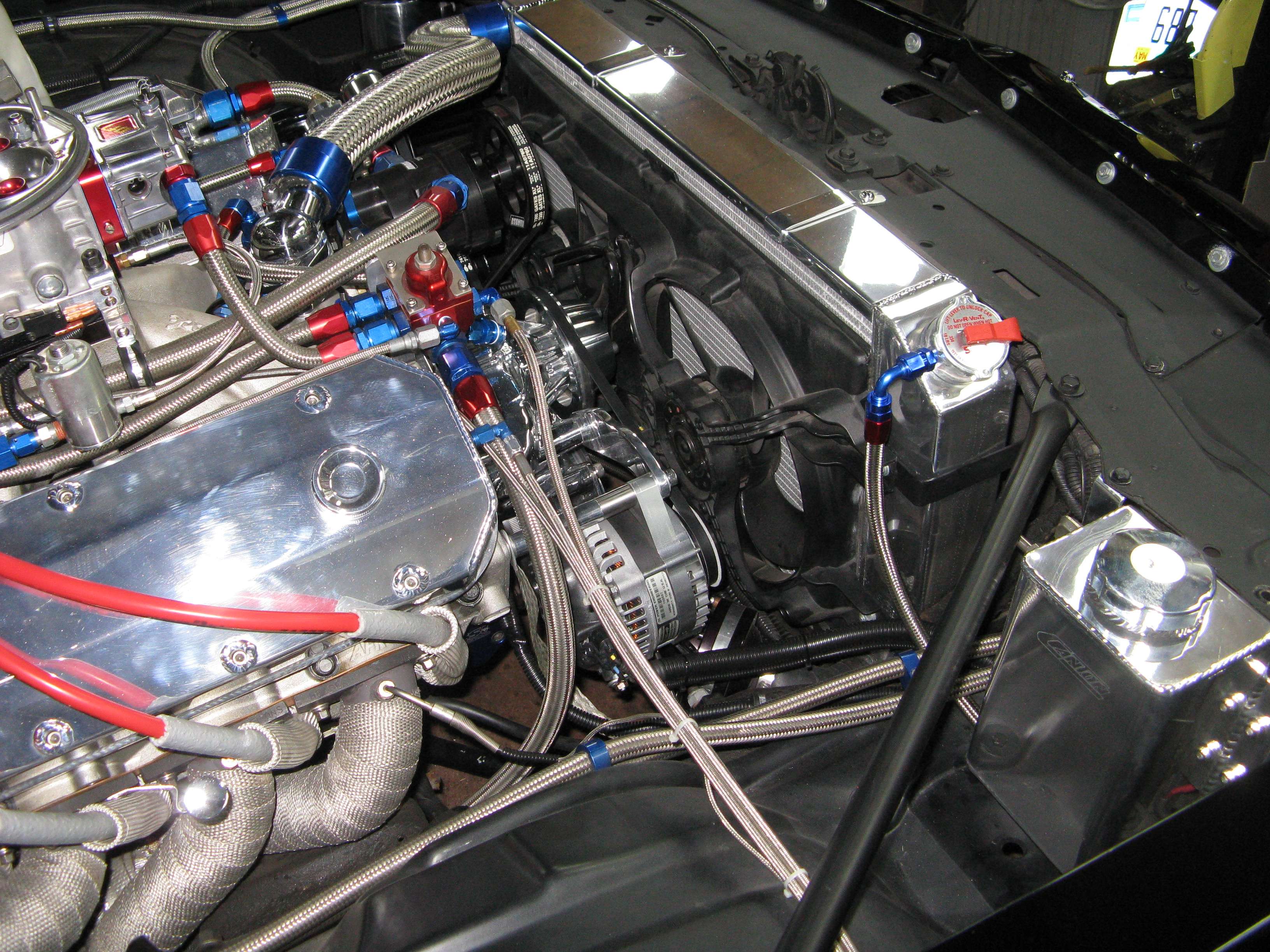

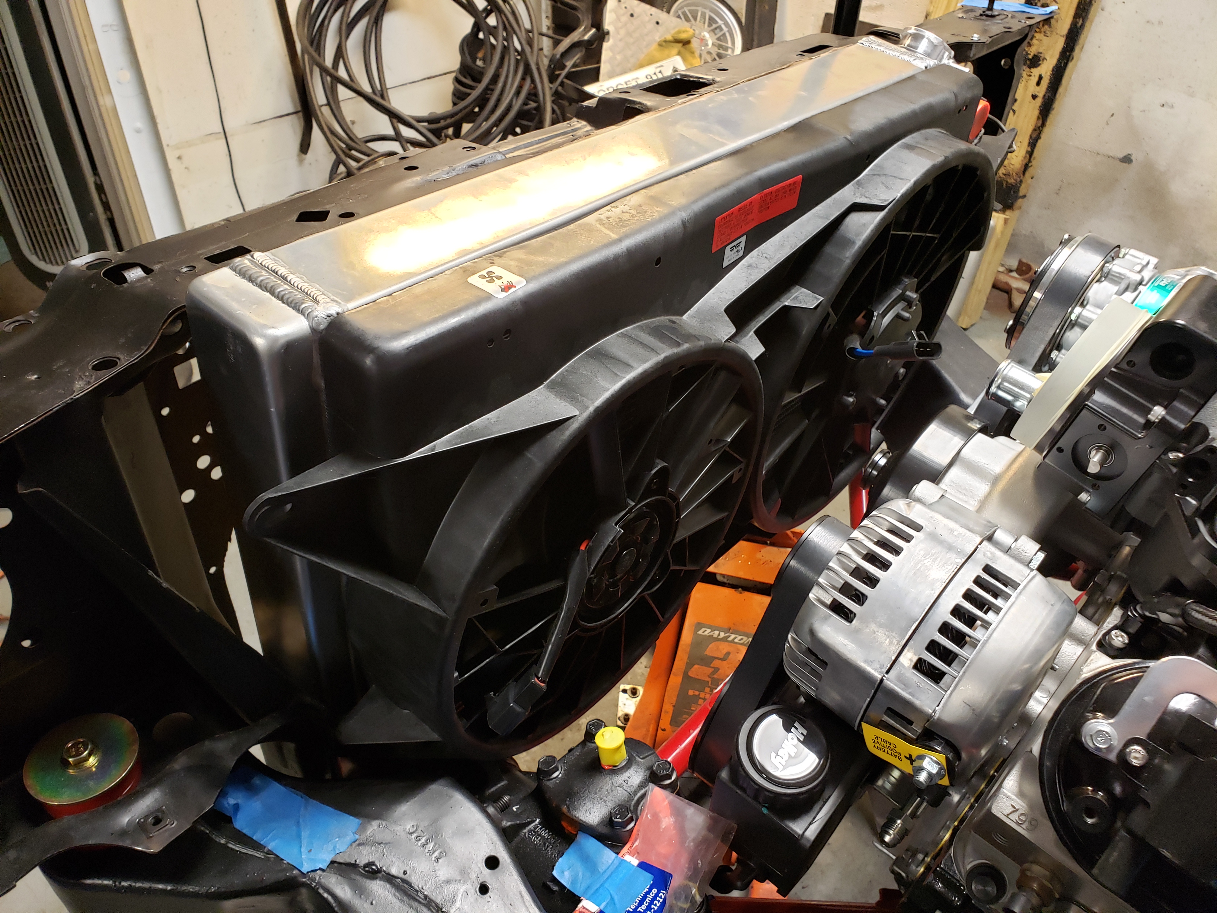

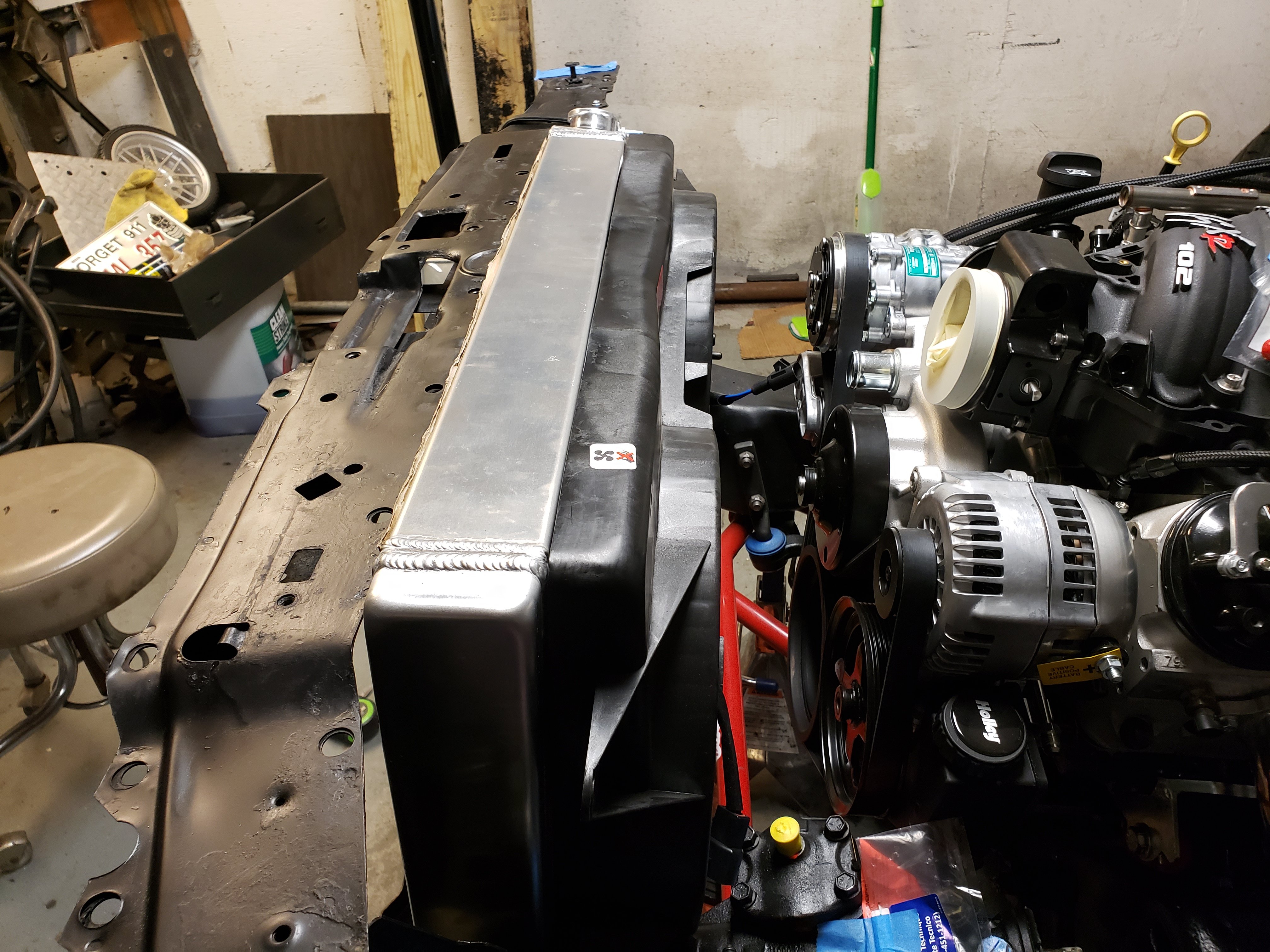

Even though both my Griffens are the same size they are different styles, on the Monte I made brackets that mount to the core support and hold the fans against the radiator using the Intrepid fan mounts.
On my Regal I cut the mounts off the Intrepid fans and made brackets to mount them directly to the radiator and then made a plate to cover all of the bolts.
Right on, I like your regal set up alot. Did u run a Griffen g body radiator on the regal?
Reactions: Tony1968
Yes, the one in the Regal has a trans cooler built in
Those fans seem to fit that radiator really well. How did you mount up those windstar fans?
I'll try to find pictures but basically the fans have 2 mounting points on left and right. Used aluminum bar from those down to the frame and bolted in. Also 2 aluminum straps up top and some small L brackets on bottom.
