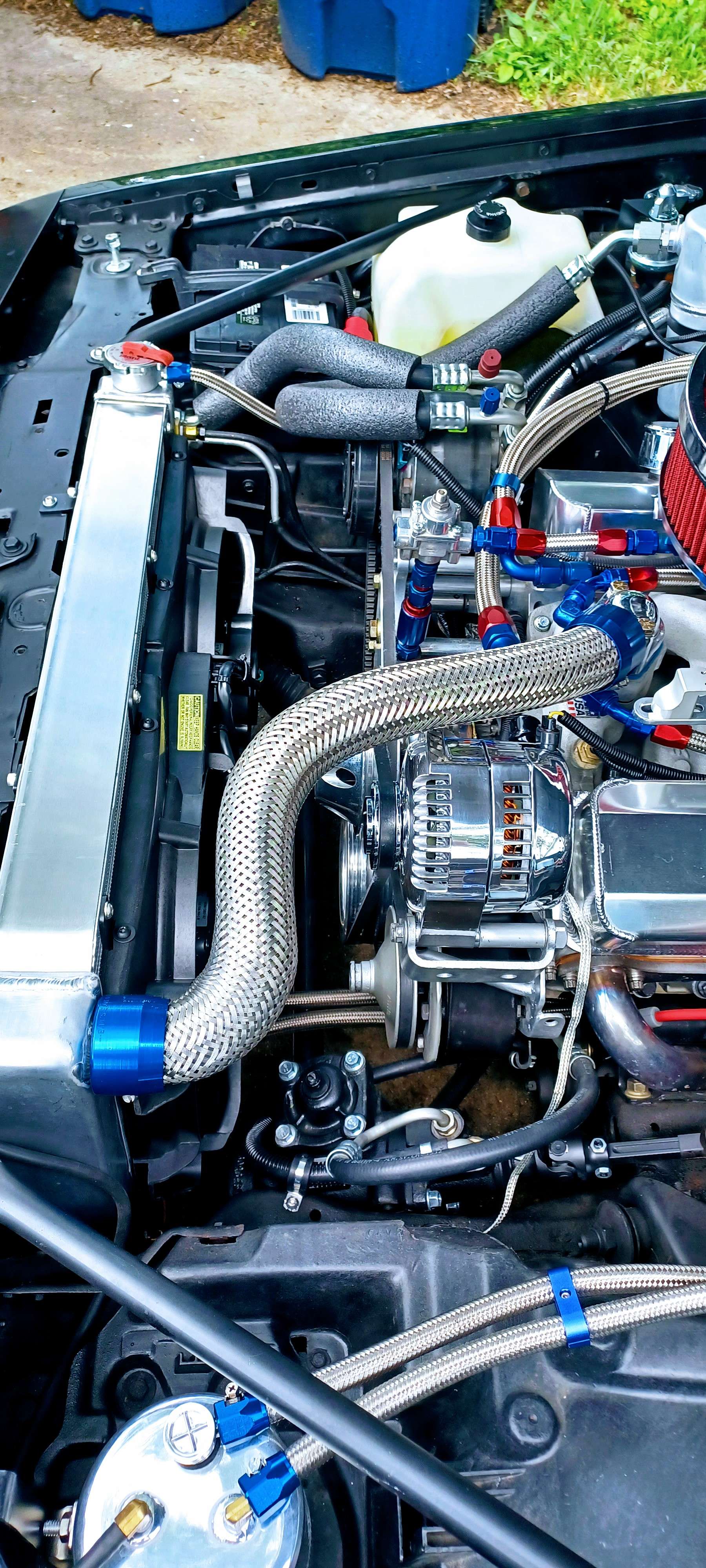

I have the Intrepid dual fan set up on both my Regal and Monte and both are using oversize Griffen aluminum radiators with 2 x 1.25" tubes.IIRC 565bbchevy has an aftermarket setup from Amazon that is Intrepid maybe, that will work and is compact. Send him a pm if he doesn’t respond.
Sweet, would you happen to have any pictures of how you mounted the fan to the radiator?I have the Intrepid dual fan set up on both my Regal and Monte and both are using oversize Griffen aluminum radiators with 2 x 1.25" tubes.
This set up keeps the 565 Big Block happy on the street and cools the Regal ridiculously well.
This is the fan I bought for the Regal
