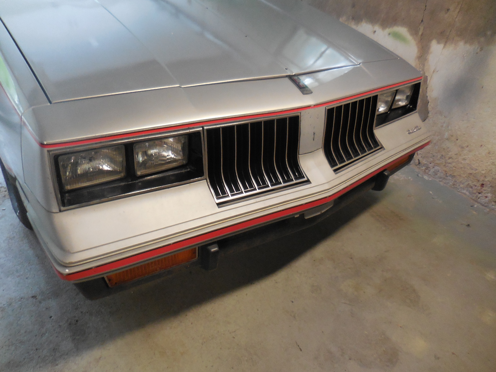

Adding a pic of the grills and headlamp doors re-blacked. Cleaning things like this up really adds to the overall appearance of the car.
Looks nice!
