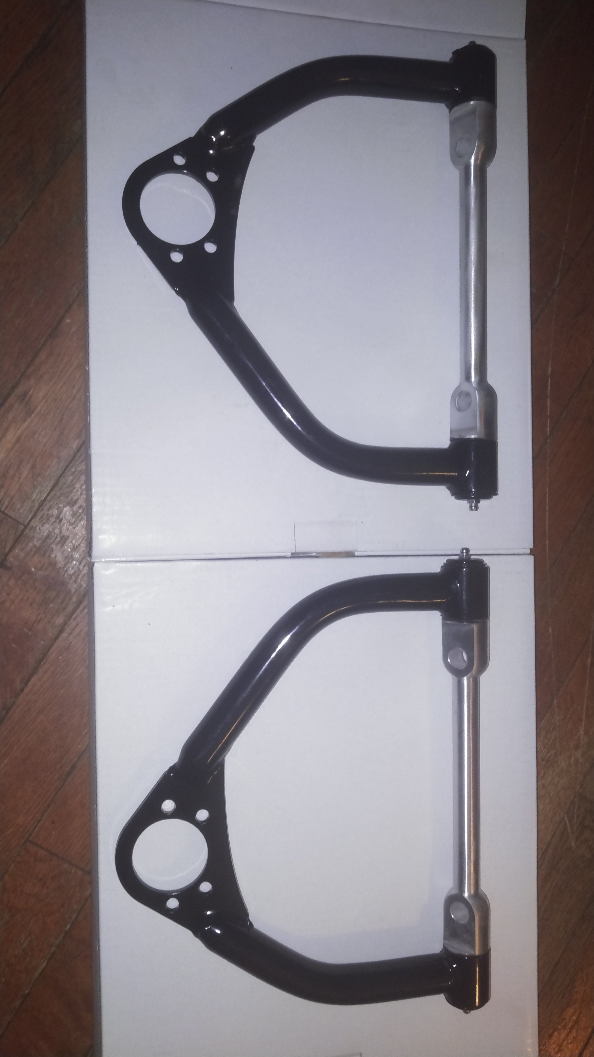

So here they are. I can't believe how light they are! And we'll built for the cost 2 right side speedway motors circle track arms. 😉

you might want to put on 90 degree grease fittings on those to make it easier to grease when they are installed. Another thing if you are not aware the cross shaft gives you a 1/4" variation depending on what side you use and that you need 1/2" bolts for the control arms. I opened the holes in the bracket on the frame for a tight fit for the bolts and used a cold chisel to make some splines in the bolt to make sure it stays in place.

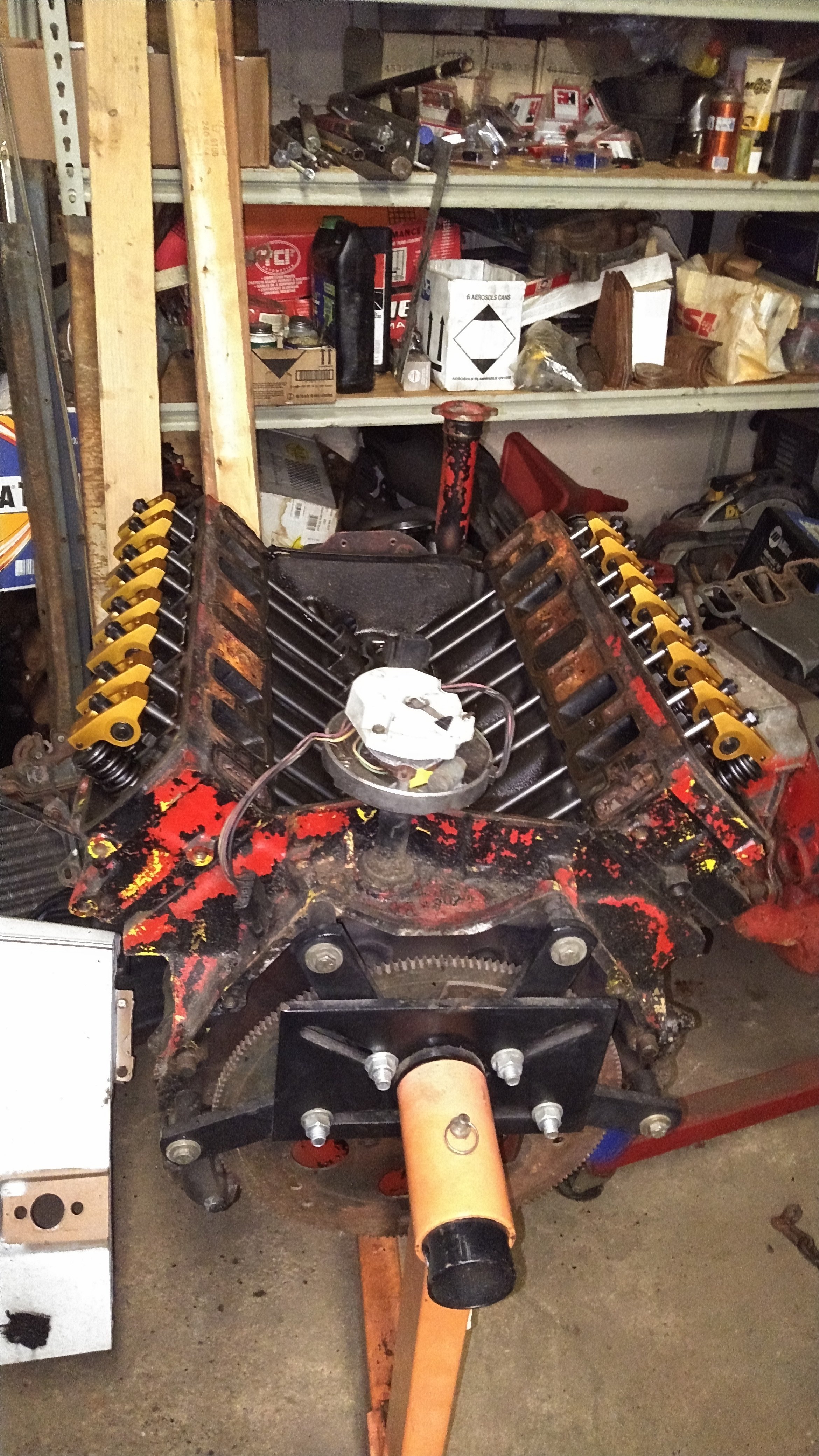

I made it out to the building a little after 12 today. I brought bolth 455s with me but didn't really get a chance to work on the car. We rearranged cars again. We put the 928 in the trailer because it's leaving put the 62 Plymouth gasser inside in front of my car and we put the cab on Eric's SS454 truck and stuck that back inside tomorrow I'm going to Fab up his bed brackets. I know that seems off topic but it's kinda hand in hand because he pulled a Chrysler 8 3/4 out of who knows where and I'm going to be using the center out of it in my car it's a 489 case with a sure grip and Richmond 4:10 gears. A bit much gear for the car but I plan on running a pretty big tire on it anyway. The 7.5 in it now has 4:11s I did start pulling apart my old motor to finds out once and for all what it is. View attachment 142812

Did the engine free up?
