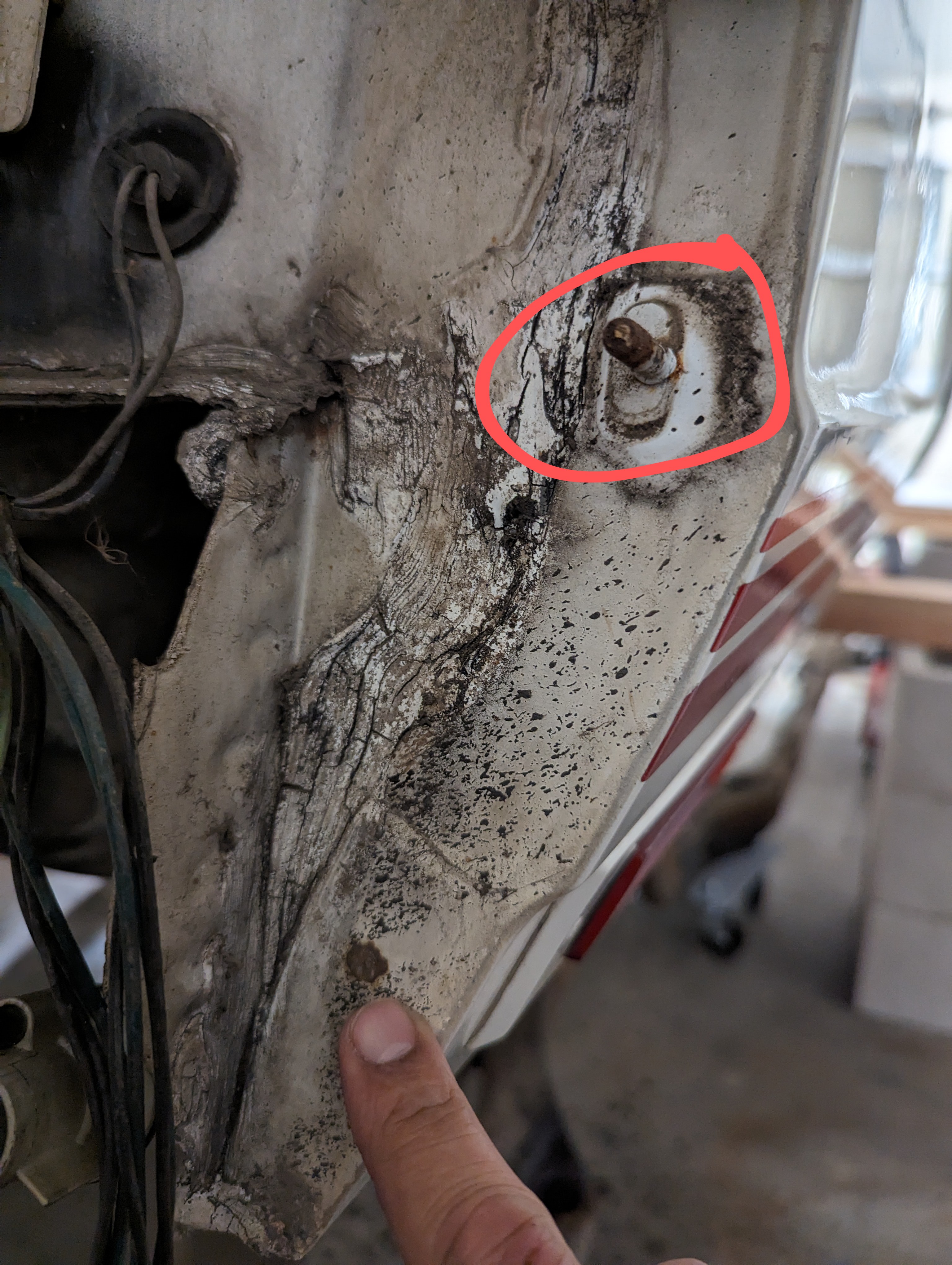

I'm gonna drill out the hole and weld in a bolt. You could also jbweld it in if u don't have a welder.I have an issue with one of the bolts that is welded onto the body for the rear plastic bumper cover. The bottom one was broken off. Does anyone know a good fix?
Great idea. Thank you!I'm gonna drill out the hole and weld in a bolt. You could also jbweld it in if u don't have a welder.
