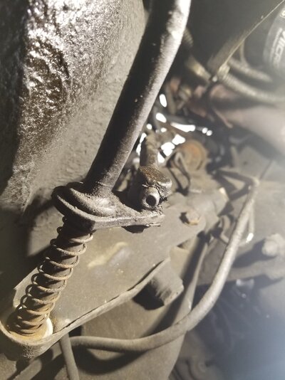

I'll assume your car has the backdrive linkage from the trans to the column. There is a bushing on the cross bar, on the frame side, down at the trans that wears out. It can be fixed on the cheap with an open end lug nut, or be replaced with an OE nylon. Now if that bushing is okay and there is no slop, the linkage can be adjusted. With the car in Park, just loosen the set screw, and push the linkage up to the stop; tighten the set screw.

Doing it right now....i see exactly what you're speaking of. Bushings are good but some play in linkage from firewall...loosen the bolt tightened things are working great now.

First, glad you figured out how to take out the slop in your linkage.
Second...Just a thought about the use of a greased lugnut instead of the proper nylon bushing here....
While the nut can be used as a temporary fix to get you by in case of a broken/missing bushing on the shift linkage, the nylon was used as the sacrificial lamb in the mix so as not to damage the bracket. Even using the greased lugnut, over time, you will wear out the bracket hole and end up replacing the bracket. Or you may not. You're just taking a chance.
