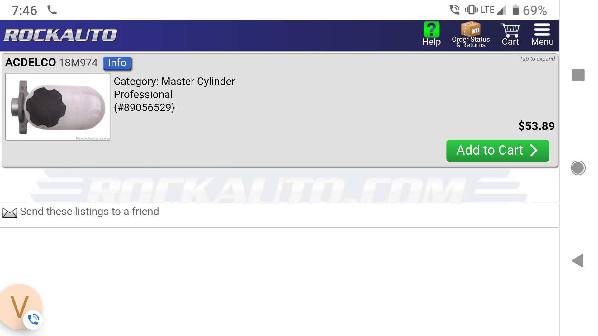

Also available from RockAuto...

I was wondering, is there a better master cylinder to use that would be more compatible with using the dual piston Blazer brake upgrade?
I'm using the typical stock cast iron unit. I'm thinking of going with the RHD Blazer MC that Turna suggested.
Does the Blazer MC have a larger bore than the standard G-body master...and is there a noticeable difference in braking power?
