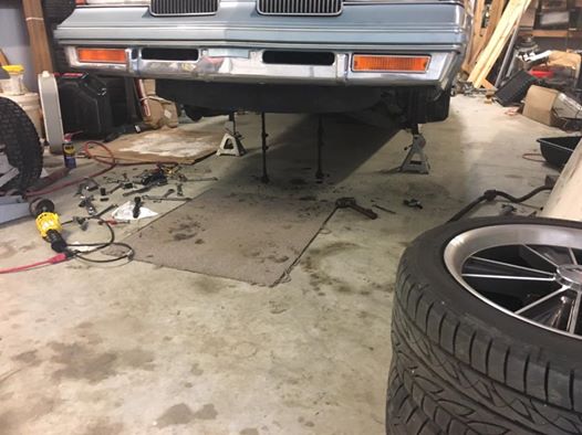

got her front jacked up, wheels off, and ready to go on round 2. Pulled the sway bar, shocks, and almost got the steering linkage. Can't get it to separate from the pitman arm, can't get a big enough swing with the hammer, and I realized I never bought a pickle fork, so she'll have to sit for now. The tierod ends looked and felt pretty wiped out.
protip: move the diagonal frame braces out of the way or the sway bar won't come out.
