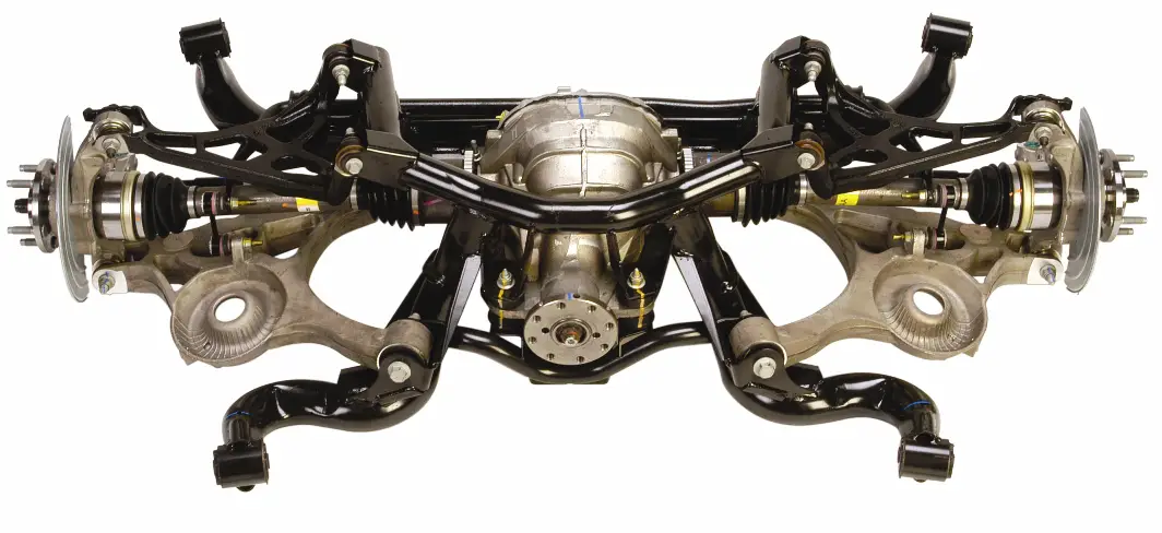

an 03/04 Cobra style IRS shouldn’t be too difficult.
The front mounts bolt in to where the stock lower control arms then just need to fab a bracket for the rear.
these are direct swaps to all foxes/sn95 and new edge mustangs. the rear frame side bracket actually i Is bolted One to the body of the mustangs. So you might even be able to use that as start. plus you get the benefits of an 8.8!

The Dodge stuff as more favourable spring pocket locations... the biggest hurdle I see is shock length. And even then you could fab up taller towers/perches.

They do suffer from wheel hop in a launch type situation. It has a huge aftermarket support and are great around corners. I’ve done a solid swap for a drag setup cobra and then the irs is a fox body coupe. Everything that has its place. The couple made for a hell of cruiser with the irs.
