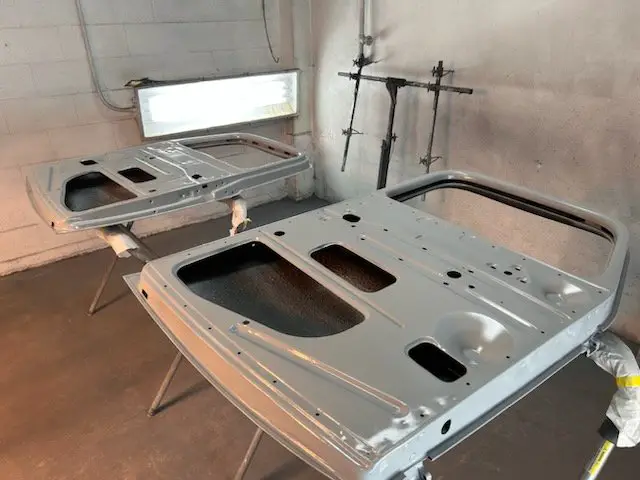

Well, this isn't the update that I had planned, but it's something. I had a talk over Thanksgiving with brother and progress was made. He's got the doors finished. He added reinforcement to the pulls. They all crack there.
He's got the doors in epoxy. The cowl vent and the dash are done too.
He's chipping away at the easy stuff first. Hopefully the forward momenentum continues.

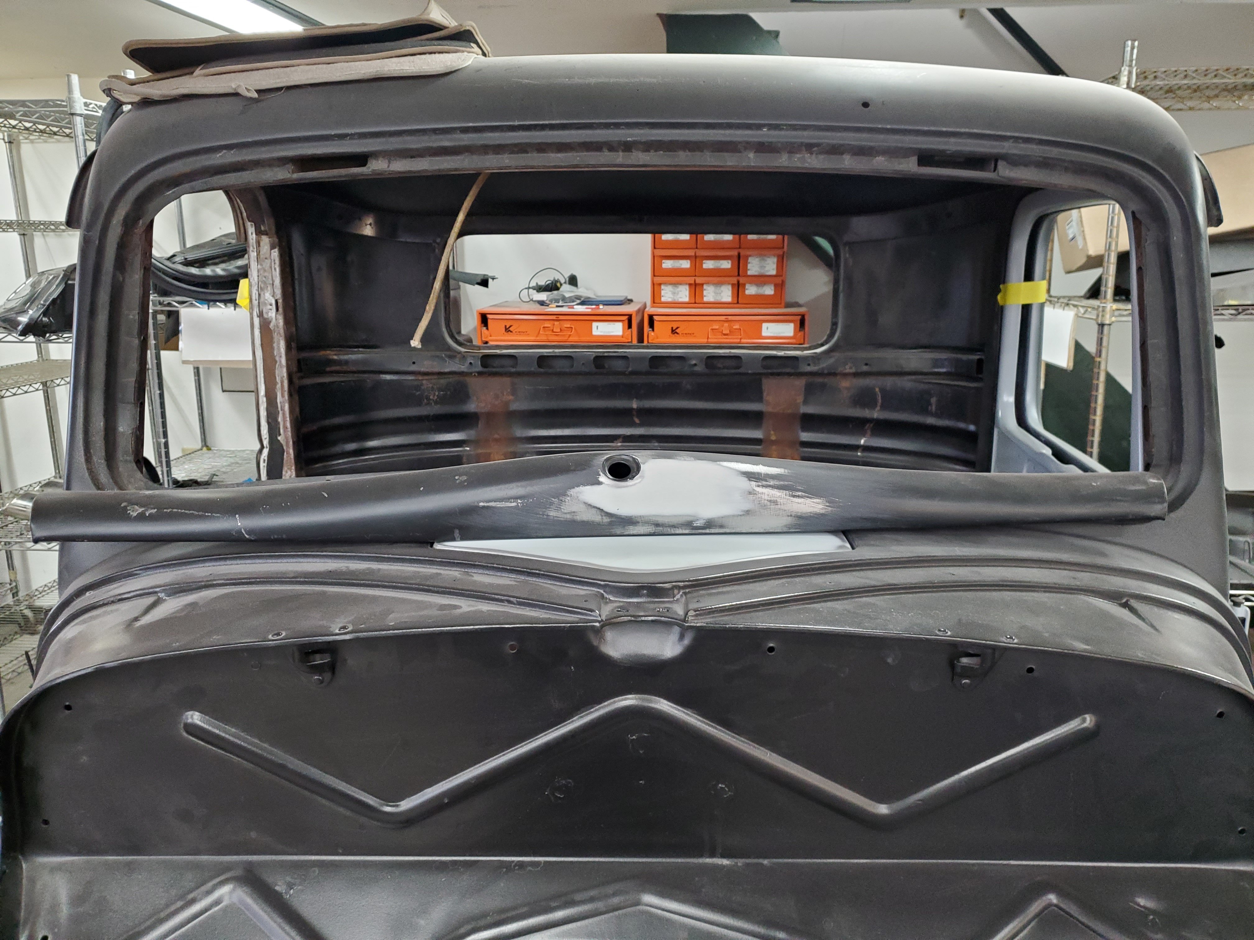

He had his work cut out for the body lines under the window. It's perfect now. Not quite ready for primer, but close. Firewall is just getting started.
Well, this isn't the update that I had planned, but it's something. I had a talk over Thanksgiving with brother and progress was made. He's got the doors finished. He added reinforcement to the pulls. They all crack there.View attachment 249958View attachment 249959View attachment 249960
He's got the doors in epoxy. The cowl vent and the dash are done too.View attachment 249961
He's chipping away at the easy stuff first. Hopefully the forward momenentum continues.View attachment 249962

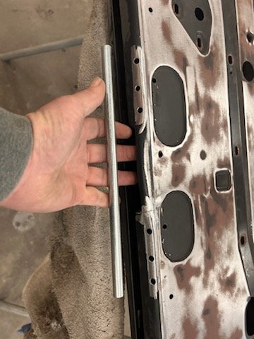

Where is the reinforcement? Is it to the doors? I can't seem to make the pictures mesh in my mind. Thrilled to see it's getting worked on.

I guess I could have explained that better. If you look at this photo, you'll see a bulge above the two oval shaped stampings. That's the door pull. Over the decades, they always seem to crack out. He welded in short sections of tube/pipe on the inside to eliminate the flex. These doors will never crack again.
These were pretty sparse from the factory. No armrests or grab handles, just a ledge below the glass. Hell, the door panels and headliner were cardboard. They don't have much in the way of cushion either. Slam the door with the window rolled down and it's almost guaranteed to crack the glass.

He said he's just tackling the cab one portion at a time, doing the easiest stuff first. There's still a lot to do. The back of the cab is going to be a major chore to fix the I'll fitting patch I welded in. The shape is all wrong. He's saving that for last.
