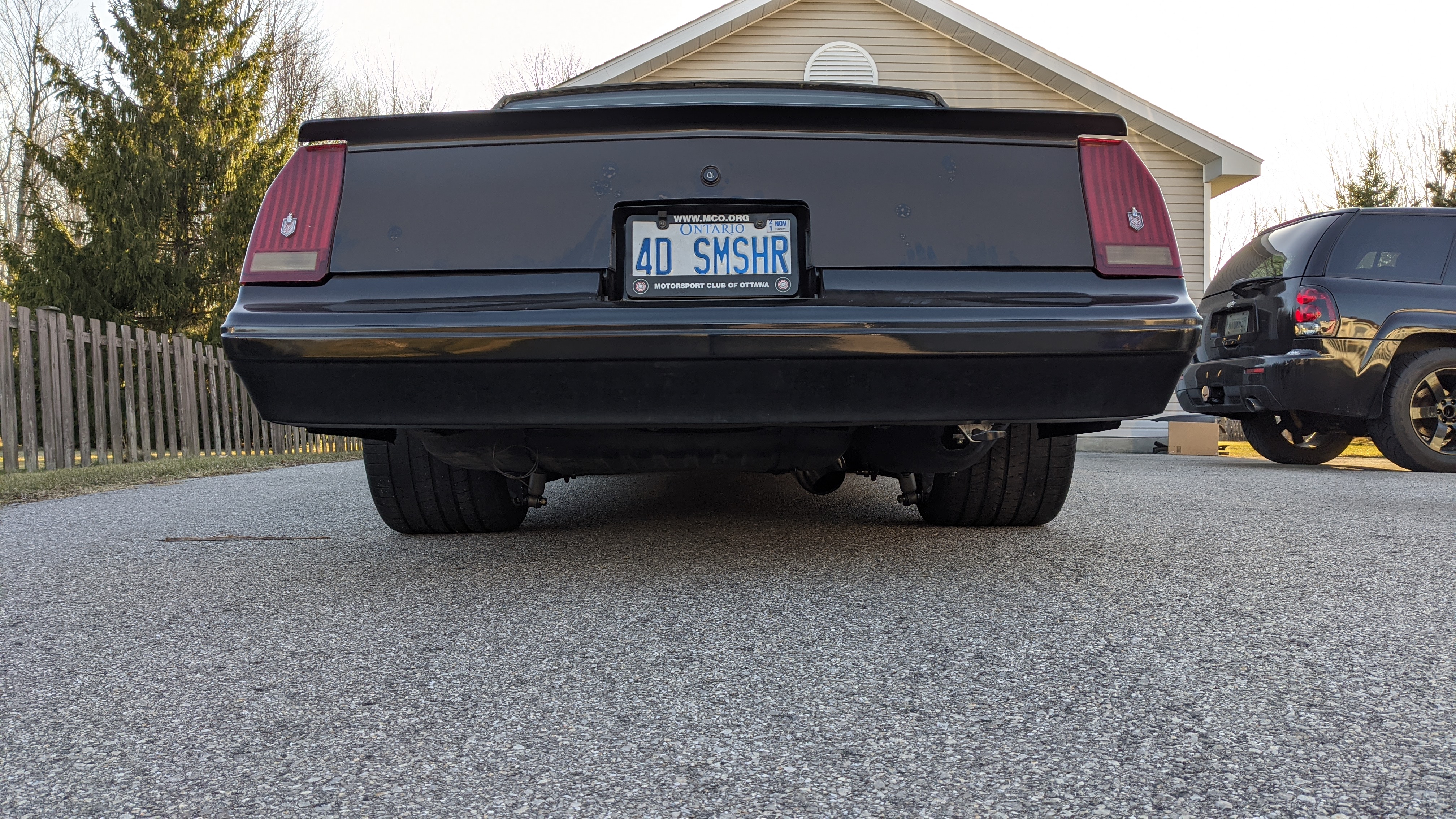

Built a pair of raised spring perches and some (6) 1/4" plastic shims for added adjustment. Got the differential down off the snubber so that was a plus. It is going to need some more tweaking... but, we are moving in the right direction.
Oh, and this happened... tuckin' 325s.
The front is sitting on the bump stops, so it is weight jacking it to the rear. Going to need those drop spindles and tall BJs soonest.
Hello Kitty...
Fat bottom girls.
Yes, I am flexing on you.
