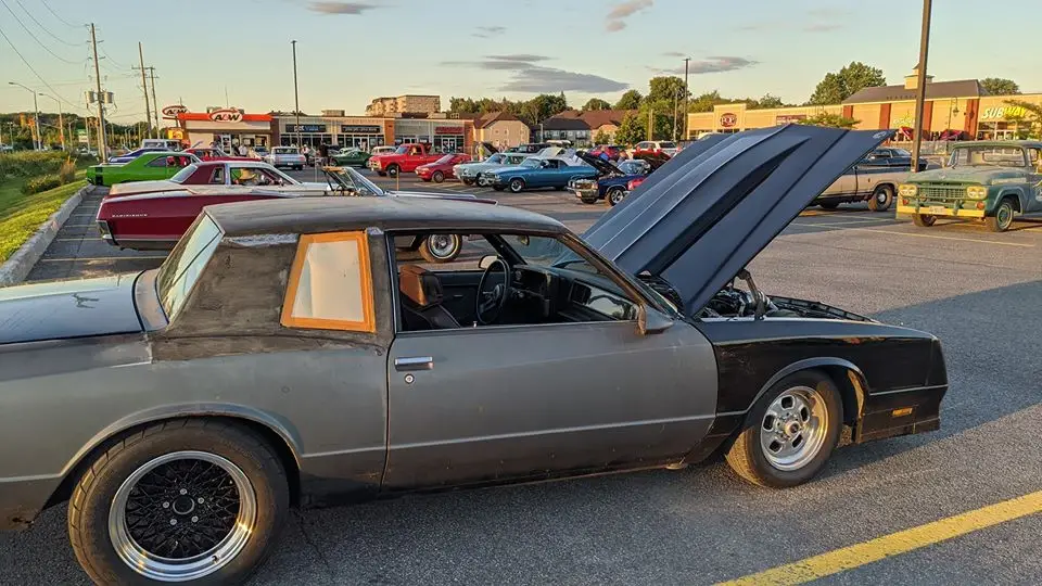

Had my oldest riding shotgun tonight in the wagon while we were out cruising, just to find out that our town is running the local car show again. So we stopped in. After a short stay I took her home and came back with the Monte.

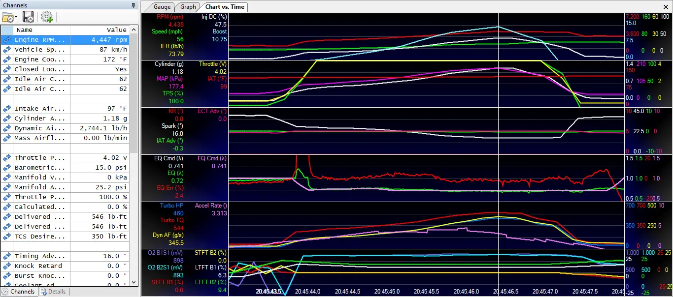

On the way home I played with the boost controller (set it to 60% DC) and it gained another pound of boost.

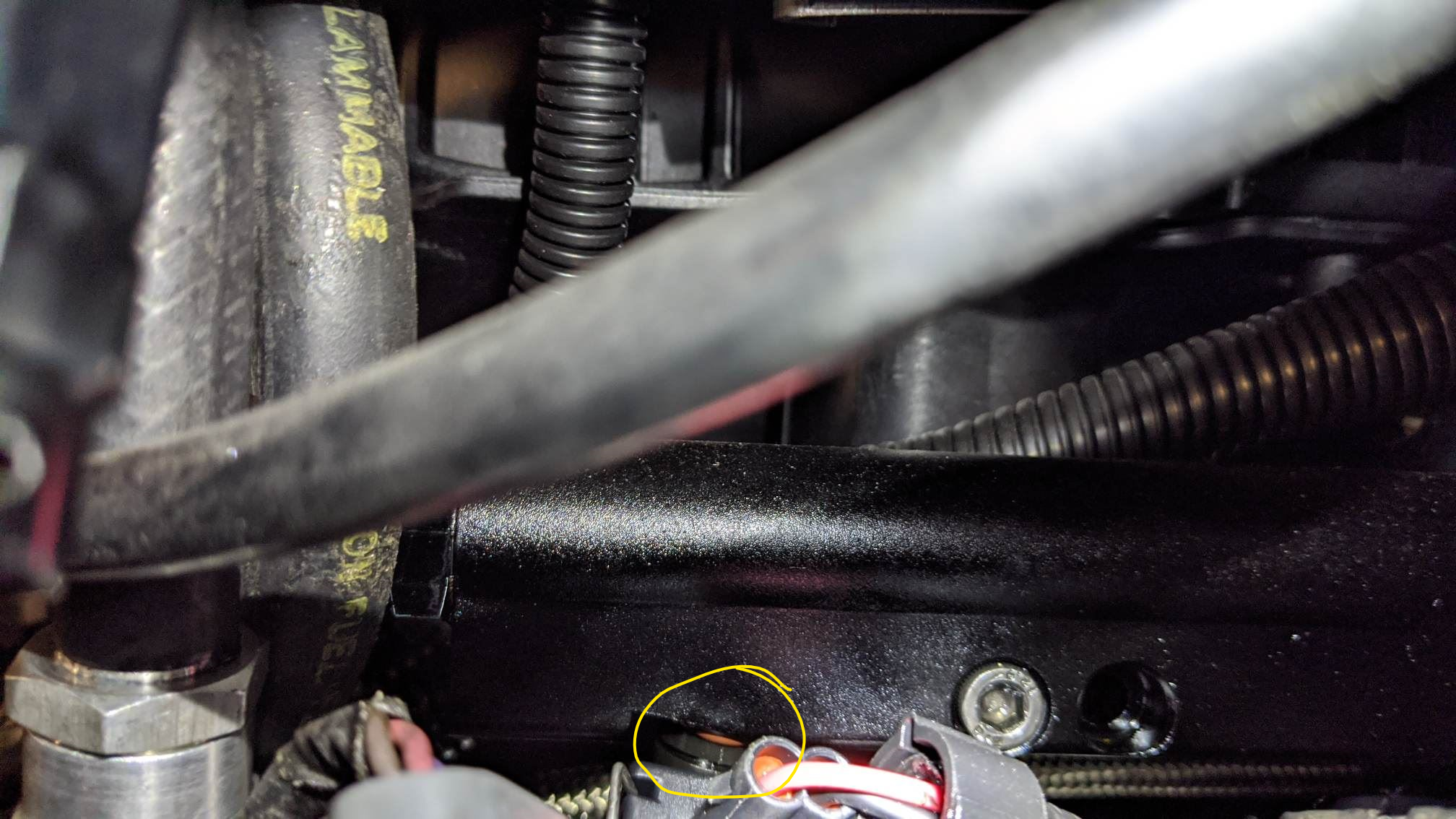

...and then, right at that moment, this little guy decide pop out and say hi.
Making a big ol' stinky mess of things. Pucker factor was a solid 9 out of 10.

Why do you need rising fuel pressure with injection?
That's a new one to me
I mean if you have like 20 to 30 psi of boost I get it but 10+ ?
I am running a lower base pressure (47.5psi vs 58psi) so the IFR is already lower than rated in an LS application, one reason for this is the pump flow rate will taper off at higher pressure - so that is one reason. The other is to maintain an equal and predictable IFR to ensure that the IDC doesn't rise higher than necessary; this makes tuning far easier (my TBSS is tuned with a static pressure - it works but is not ideal). And just because I am running a single pump, smaller injectors, and a few pounds of boost today doesn't mean there won't be dual pumps, 1500cc injectors, and a Pro Mod turbo on this thing tomorrow. Room to grow.
