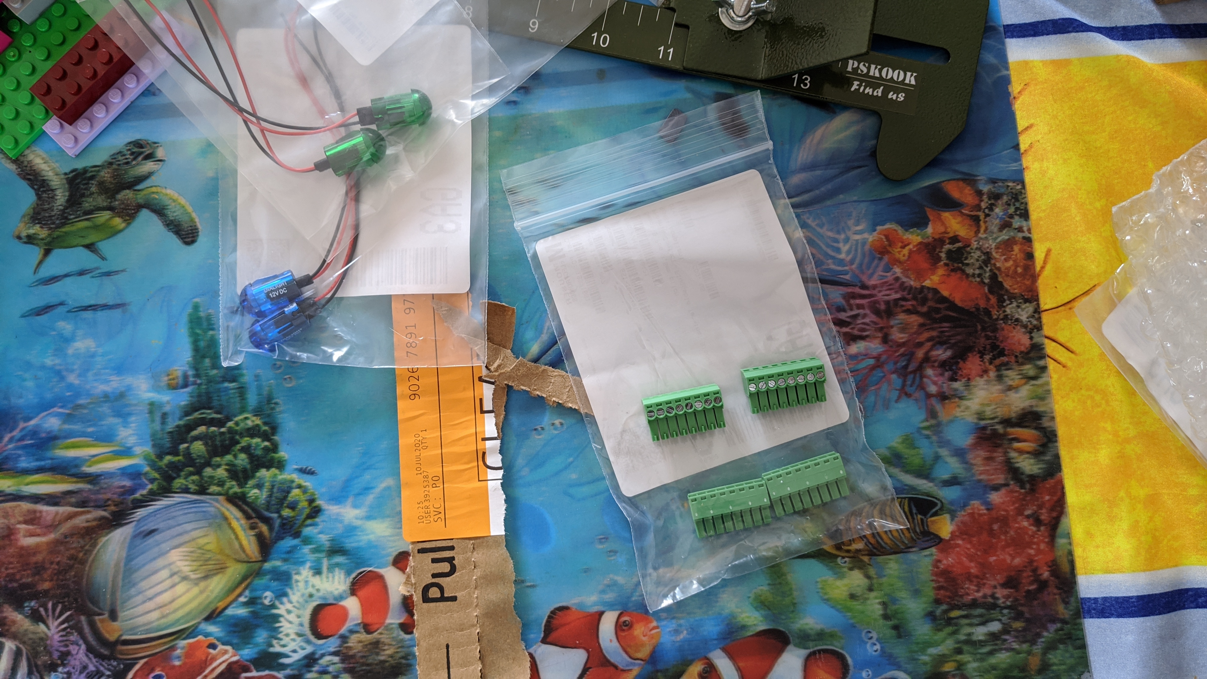

LEDs are here. As are the some EIO plugs for HPTuners MVPI. Two are $14 (same as OEM) and two are $2 knock-offs (testing their performance). F*ck paying mark-up on a simple part.
Bought enough for all the cars that have WBO2s and other sensors because re&re-ing these is an annoyance when tuning multiple cars and leaving wires dangling every which where is just ignorant.
Those look just like the EFILive plugs. Can you not do a serial wideband log? That's how my widebands are set up.
