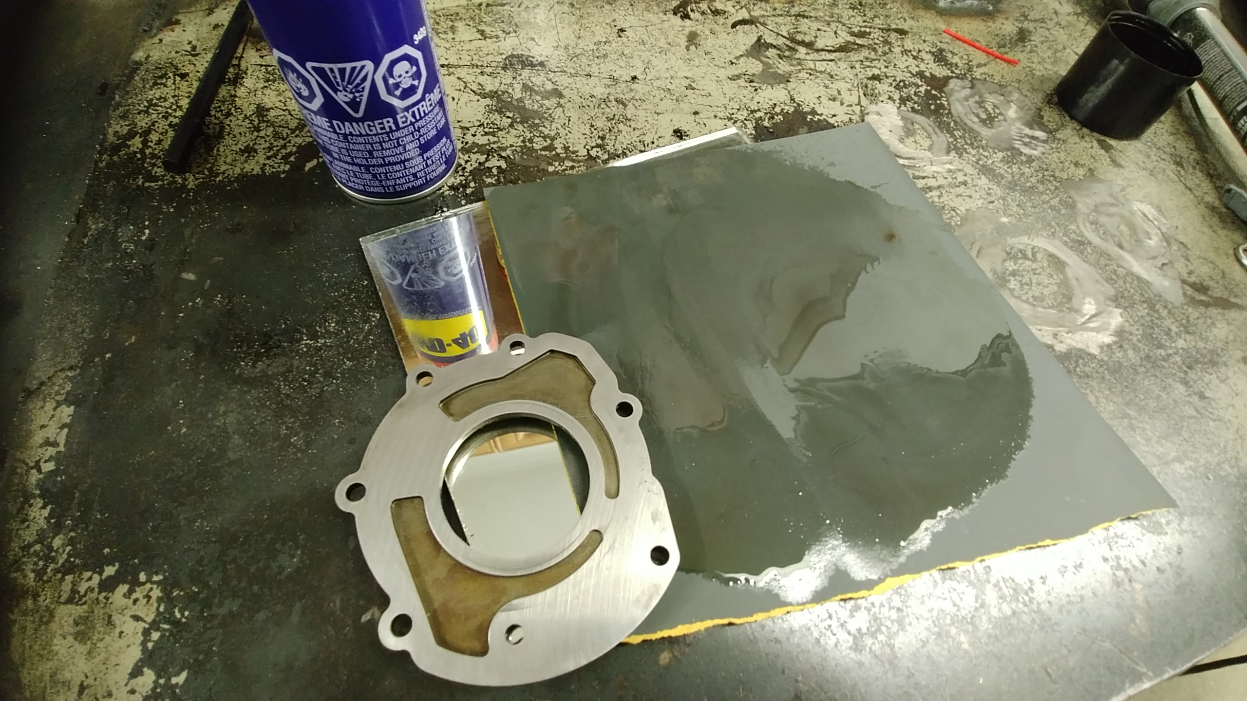

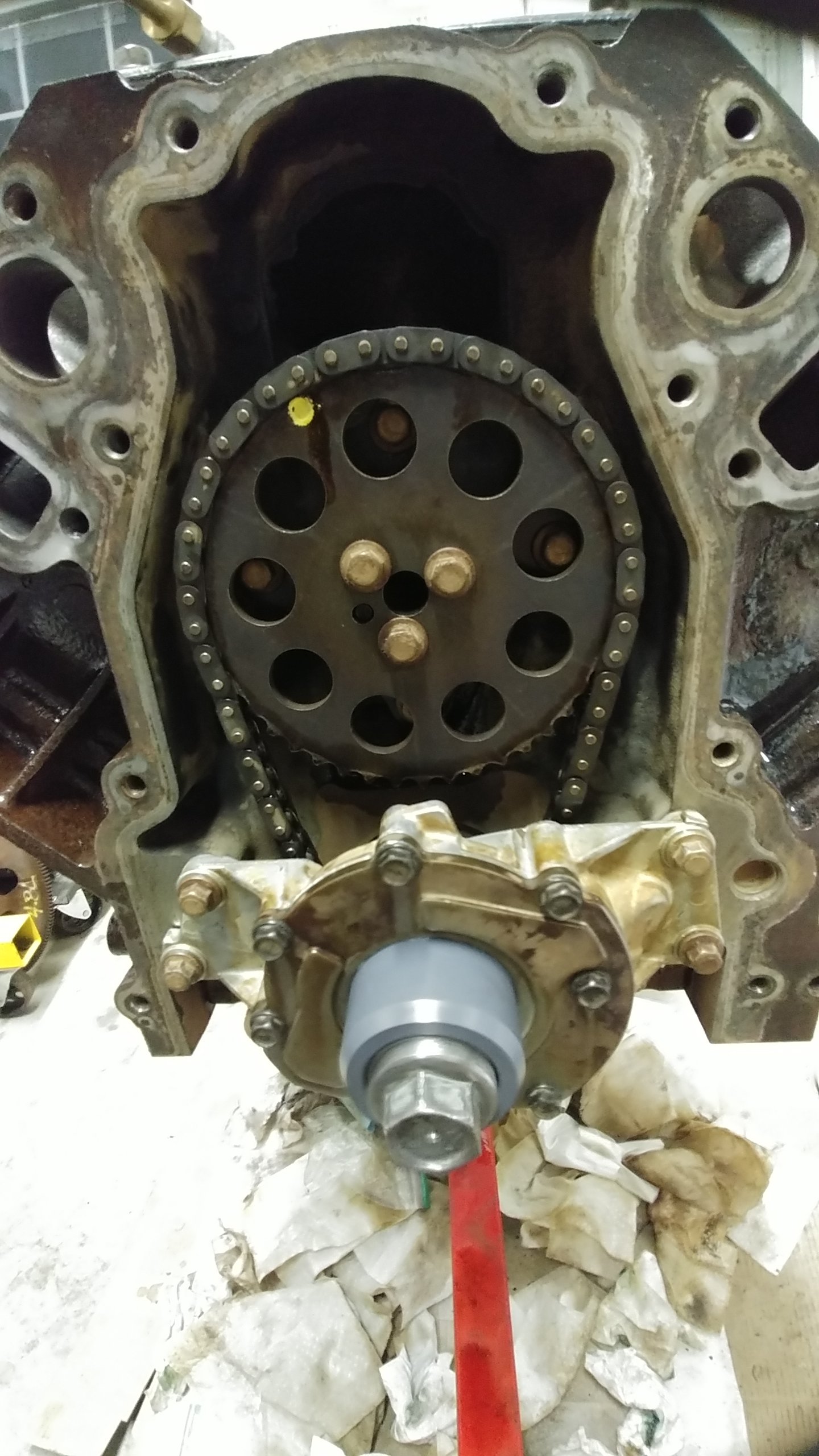

Couple of things I like to do when reworking a stock oil pump:
1. Port it for better flow and less restriction;
2. Lap the faces of the housing, plate, and inner and outer rotors - 1000 grit;
3. Shim the relief spring (used .125") this time; and
4. Pack that b*tch with Vaseline and break-in lube.
When you install these things you don't need to go through an extensive shimming procedure to centre the rotor/housing. I just jam this tool on there and she is right as rain.
Oh and blue Loctite on the bolts.
Hey Mike is the first pic is it ported already and then jammed packed with vasalean?
