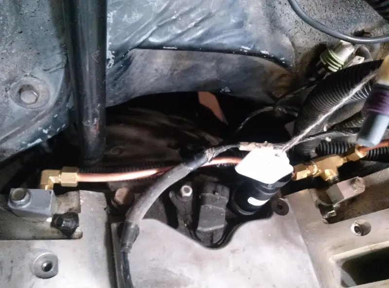

I did the same thing on my 2+2. Nobody has a 4 port setup for a blower intake that sits flush to the valley cover so I had to head to the hardware store. People said it would work harden and leak but its been 3 years and 5k miles or so and its been fine for me.
Work hardened copper, eh? As opposed to a ruptured rubber hose or a rusty steel line? People love to talk and speculate. Copper has been used in automotive applications for a century or more. In both instances these are pretty benign uses for thick walled copper line. Ironically the 4.8L I picked up last Winter did come with the coveted four-corner steam line - it is just rusty and buried, and I cannot be bothered to tear that engine apart to get it (and clean it up).
