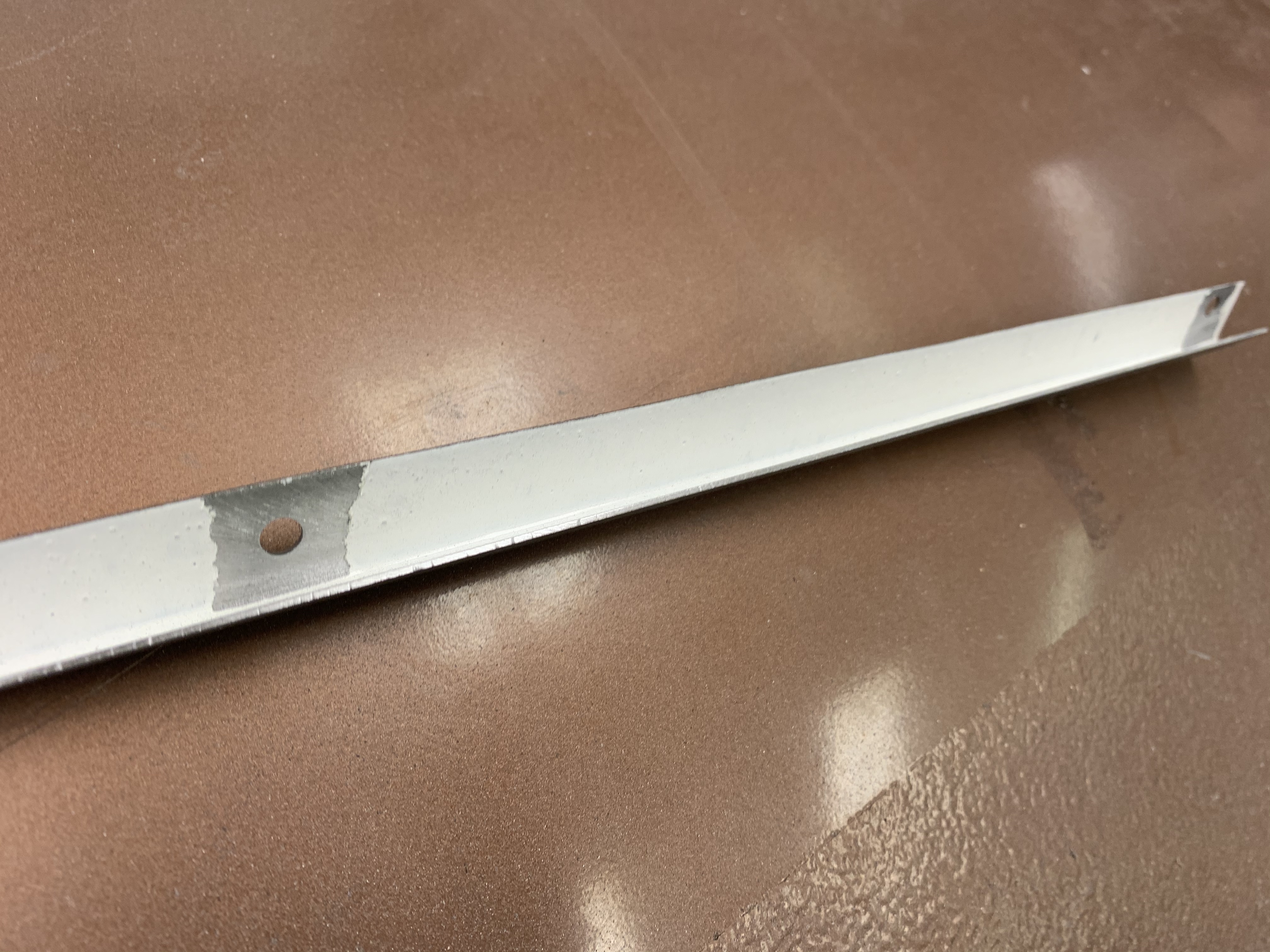

In my experience, “weld through” primer is anything but. It’s high in zinc which aids in corrosion resistance, so it’s important to use between overlapping panels, but it actually doesn’t “weld through” worth a sh*t. Whenever I gotta use that stuff, or really ANY product between panels, I always try and figure out where I’m gonna be welding ahead of time. Then I simply mask off these areas. It makes weld contamination a non-issue unless you burn a bigger hole than you planned, and get into the primer. Then you’re back to square one anyways.
So yeah. Don’t do that.
:mrgreen:
When I repaired the bottom of the driver’s door, I had to spot weld the hemmed flange on the inside to the main structure. A simple piece of masking tape applied before I sprayed epoxy where it was gonna be spot welded, eliminated the possibility of weld contamination:
:mrgreen:
