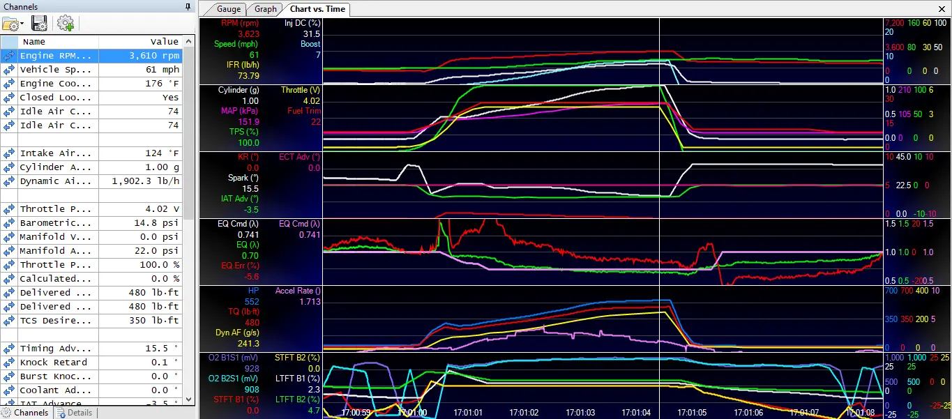

I think I built a diesel - 550+hp at 3600rpm... Dafuq? Added a tickle of boost and this thing is became very traction limited with the crap tires that are on it. During a 2-3 shift under load the damn thing went sideways on me. Guess I am getting the drag radials mounted and heading to the track... because there isn't much more I can do on the street.

Maths is hard. So is logging.
Because 5252.
Whorespowers cannot exceed terks below that number.

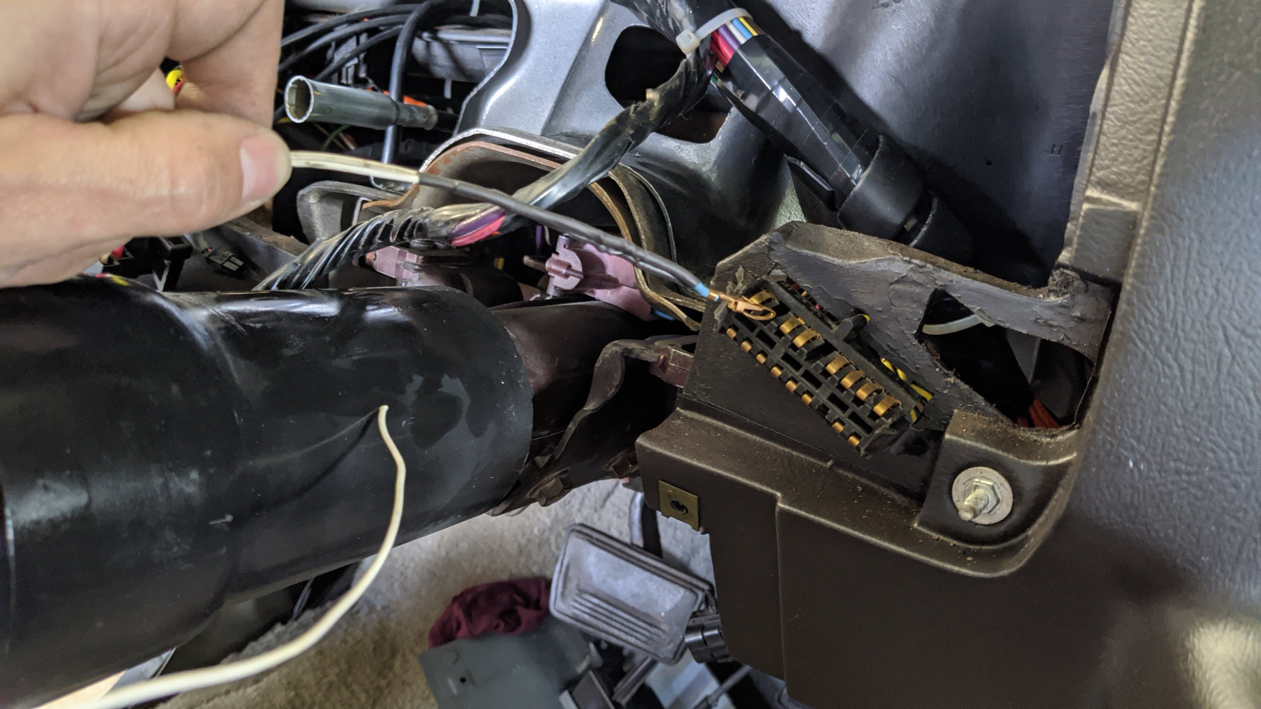

No tach? No shift light? Helps to have the signal coming from the ECM coming through the correct pin on the bulkhead connector you installed in the firewall.
Have a shift light now, but no tach?
Yeah, you need a pin in slot 17 for that.
FFS.
Man, I suck at stuff sometimes.
FFS.
