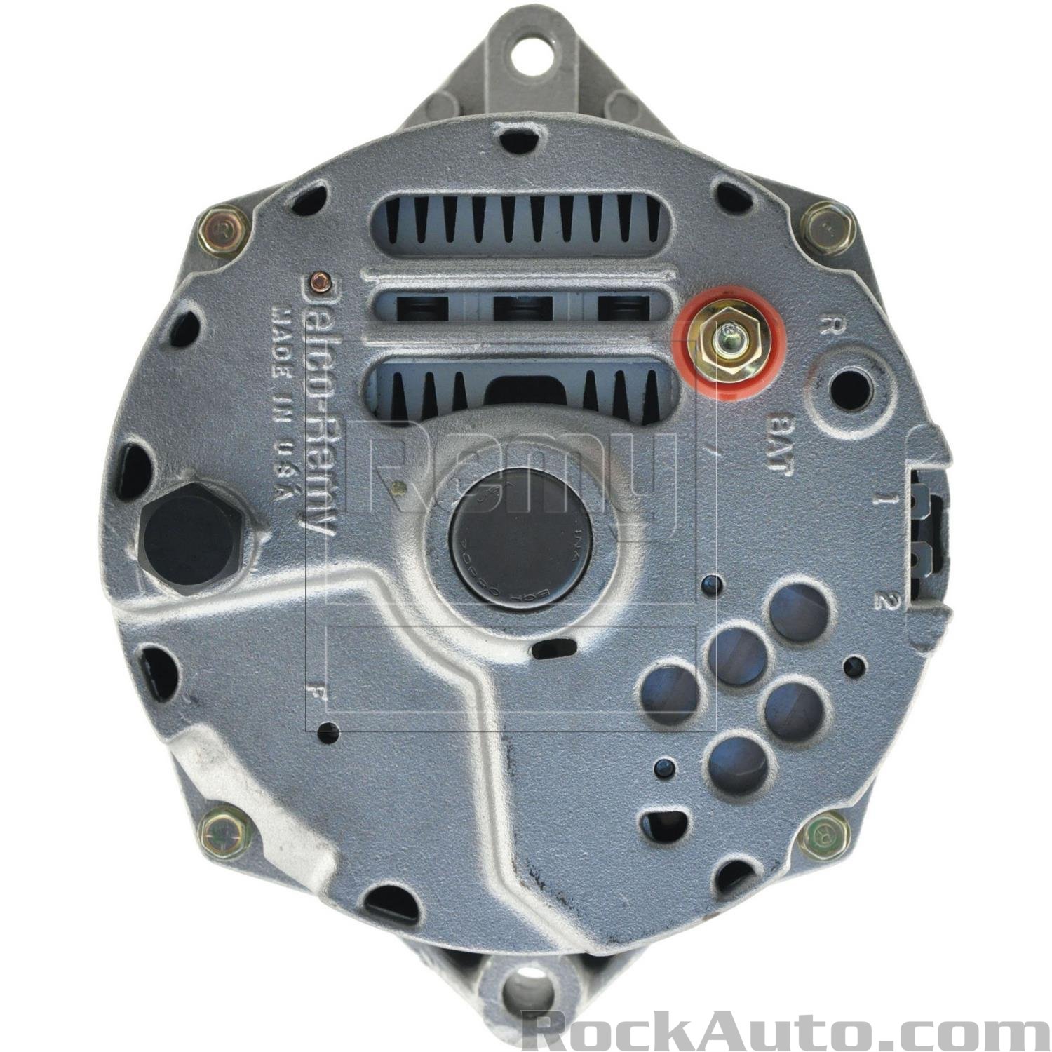

Obviously different. I have seen different clocking, must be different size cases as well.
The tension bracket ear is about 1/2" longer and the boss for that bolt is in the right place on the back. Also note the additional cooling holes in the back like your original alternator.
90 something percent of the Chevy's had the same alternators, the optional one is different and also uses different bracketry but it is uncommon.
Reactions: Sweet_Johnny
Yeah the 20239 you pictured is definitely much more of a match to my existing alternator. I also found the Remy 22100 on RockAuto, which is the 85 amp version. It seems to have the same layout as the 20239 and would match my current alternator output. Although I doubt I'd notice any difference moving down from 85 amps to 78 amps. The issue is neither 22100 nor 20239 are available locally for me, so I'll have to shop around and see what I can find. I don't love ordering things from RockAuto when I'm unsure of fitment, because returns to RA are prohibitively expensive from here in Canada.
edit: Looks like I'm confusing alternator outputs here. The 20239 is only 70 amps, the 22100 is indeed 85 amps. I'm not sure if I'd notice the difference between the two. I do not currently have subs or a real audio system. Only major electrical addition that I could see myself doing is an audio system with a 10" sub, nothing crazy in terms of power/watts though.
I actually went through the small vs large case trying to run a 120 amp CS130 amp alternator on my 70 Cutlass S. I run a serpentine setup from a mid 90's sbc truck. Well I am pretty sure you don't have a 10SI alternator, never seen this before. You actually have the rare 15 or 27si. The brushes and regulator should be the same. Not sure why a basic Cutlass would have a special large case, higher output alternator. We got weird cars up here. I wouldn't go below 85 amps, idle output is much less vs the later CS130 or other more modern alternators.
