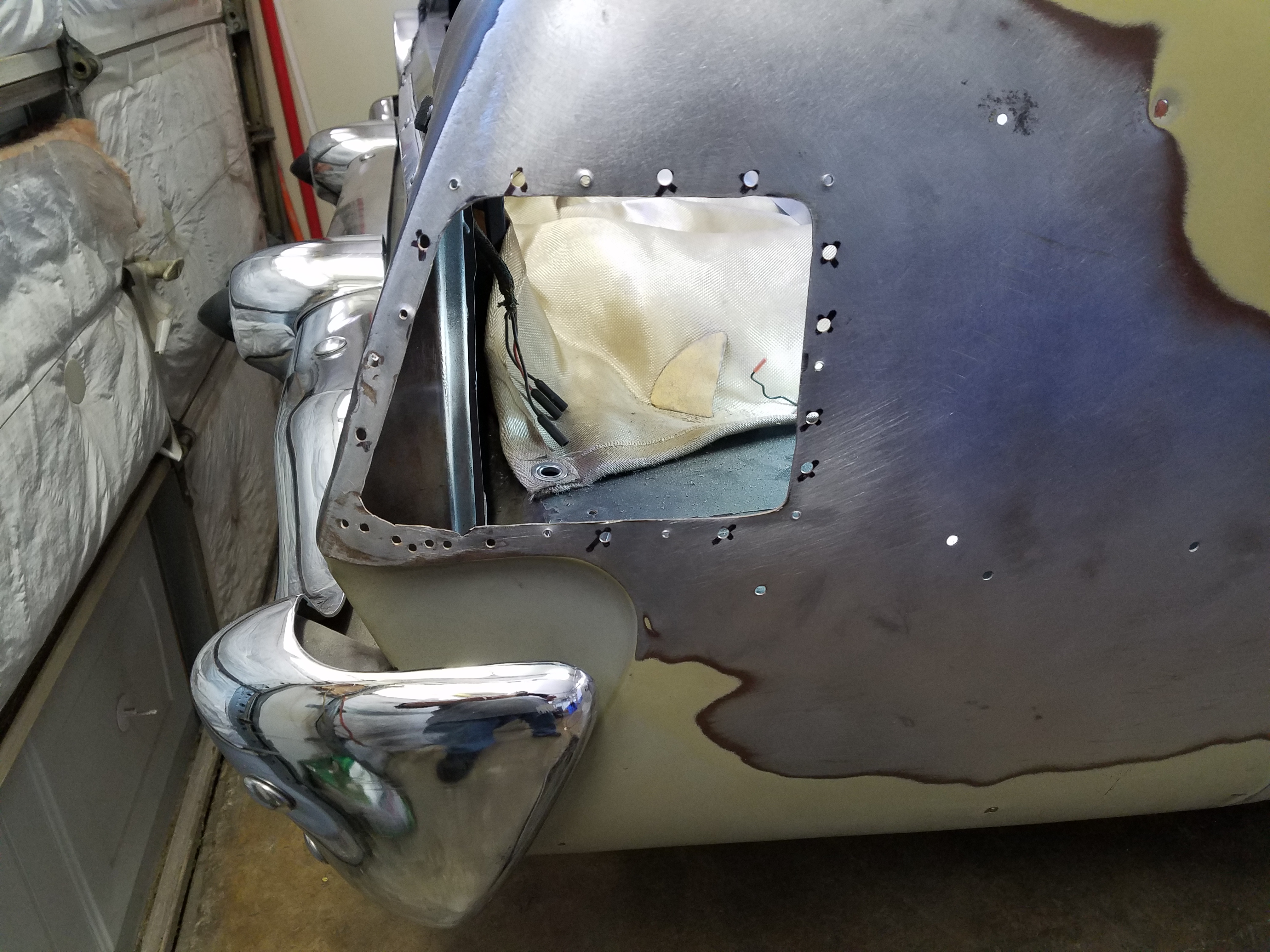

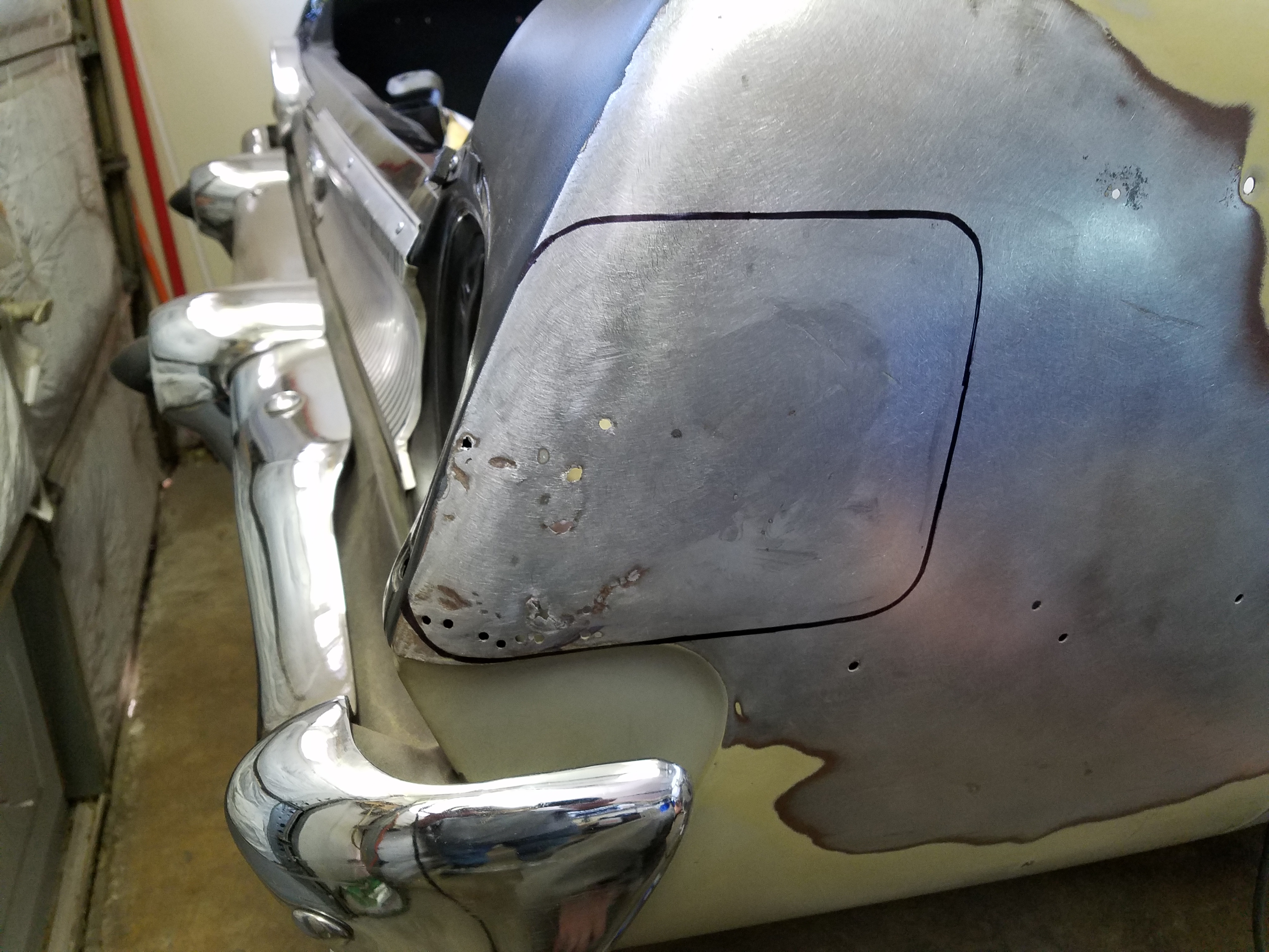

Had a good day on the Galaxie yesterday. We knew we wouldn't be working on it today because of Mother's Day so we pushed hard yesterday to finish the last patch. There was old collision damage at the end of the quarter over the bumper. Dad got it pretty straight but he actually hammered through the metal in some places. Some of the metal was just barely thicker than aluminum foil. It was way too thin to weld up. He also had some of it pushed out too far to the point that it was a high. We took a less is more approach as we have with the rest of the repair and only cut away what we had to. Here is a look at what we decided on...
Here's what the back side looked like...
Here's the car cut out, the holes drilled for the sheet metal screws and the holes punched for the plug welds....

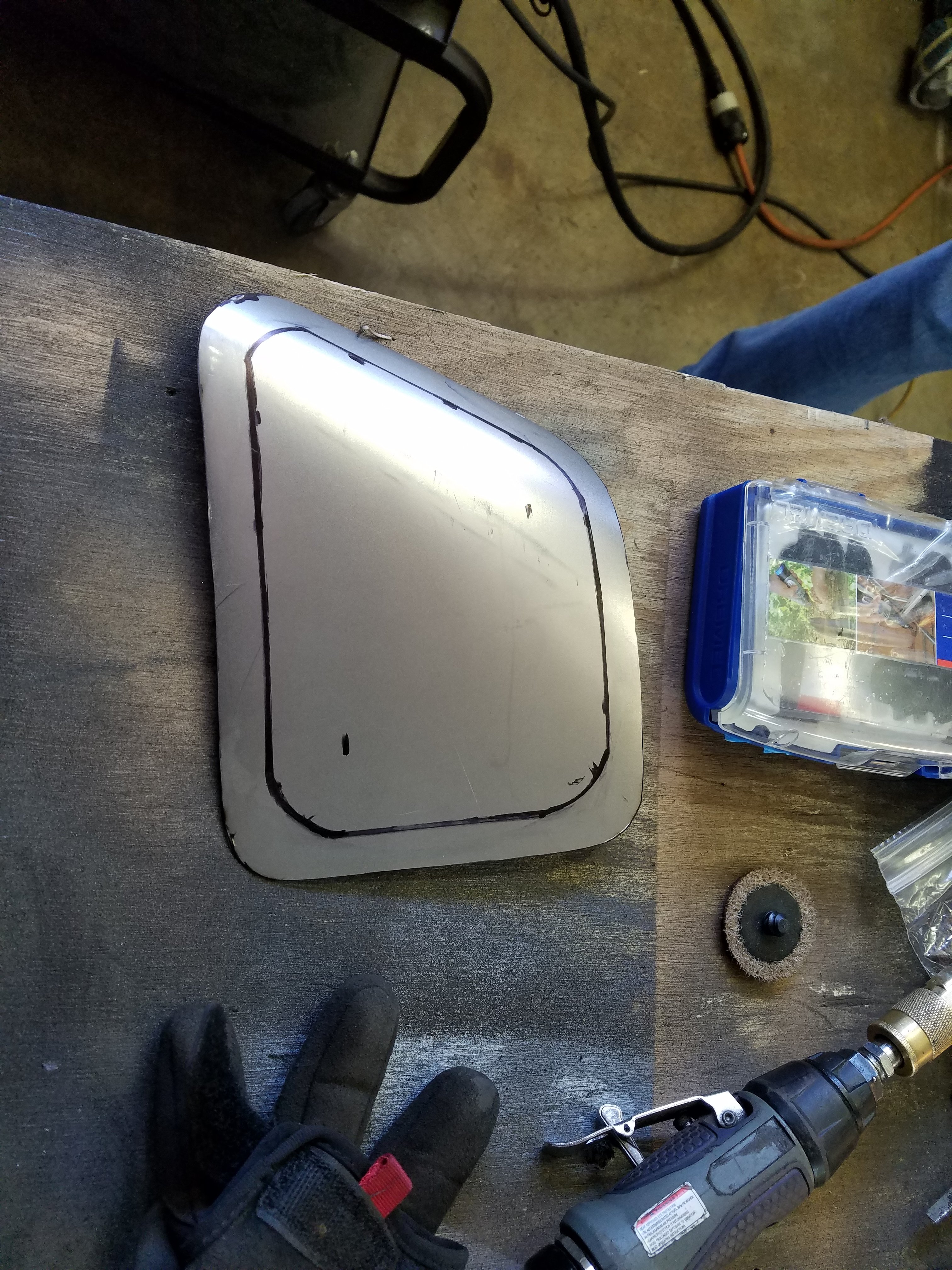

Here's a look at the patch before the flanging....
Here's what the patch came out of....

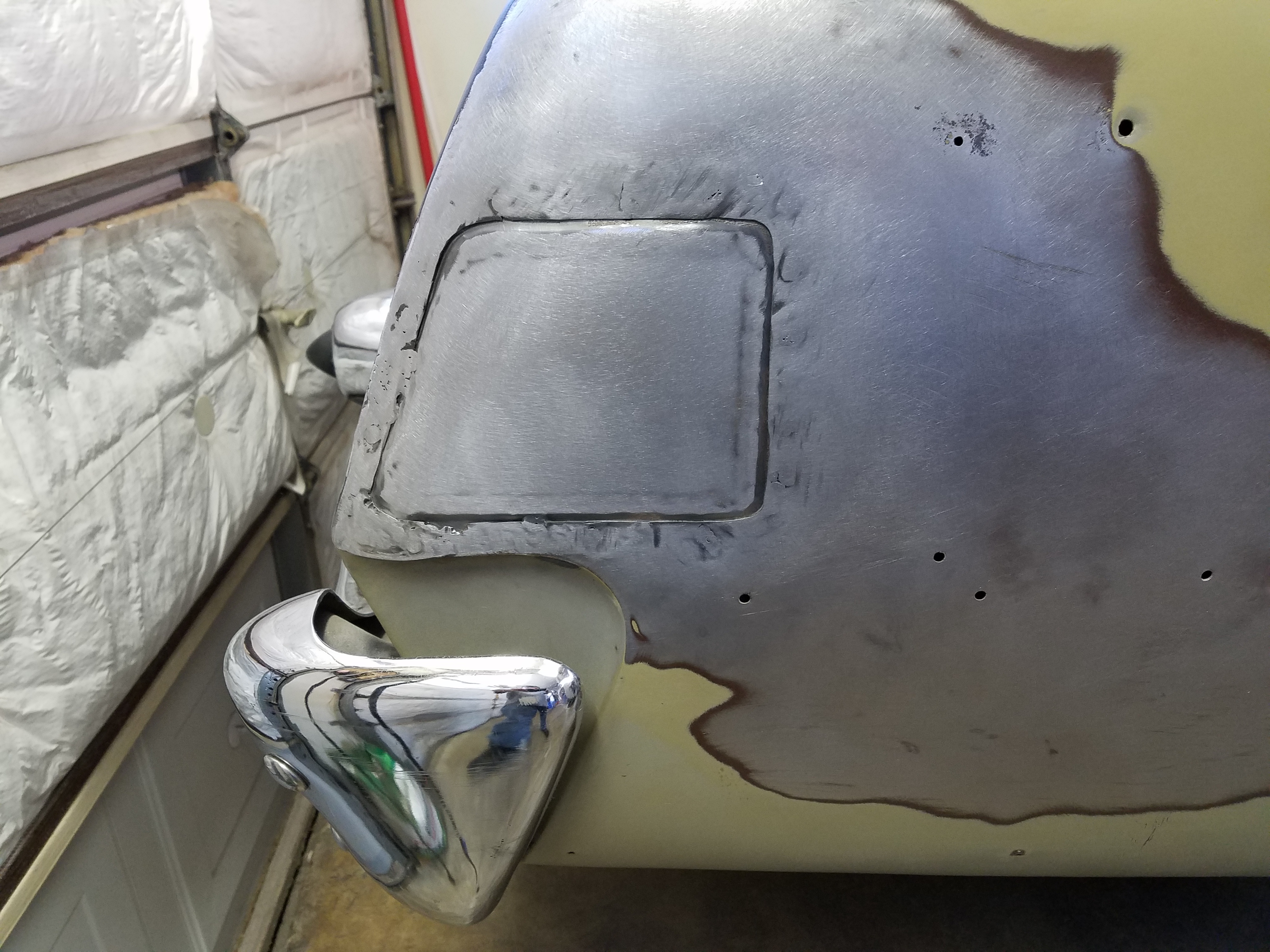

I didn't get a picture of the patch fit up before welding but here it is welded in, all the grinding done and dressed with 80 grit DA paper. It turned out well. There was some tin foil metal at the back edge that did a lot of burning up but I overcame it....
The metal work is finished. It's kind of a shame. I feel like we just now are getting good at it. I'm handing it off to Dad and Sean to do the body work. They will prime the rocker, quarter and door jamb. They have quite a bit of seam sealing work. They will work the repair seams with Evercoat metal to metal and then do finish work with the rage extreme. They also have to refinish the inner edges of the rocker, wheelhouse and trunk drop off where we cleaned it up for welding. They have probably four weekends of work but I will be checking in and updating this thread. Dad is happy. He knows it's going to happen and for my brother and I, that's what its all about.
