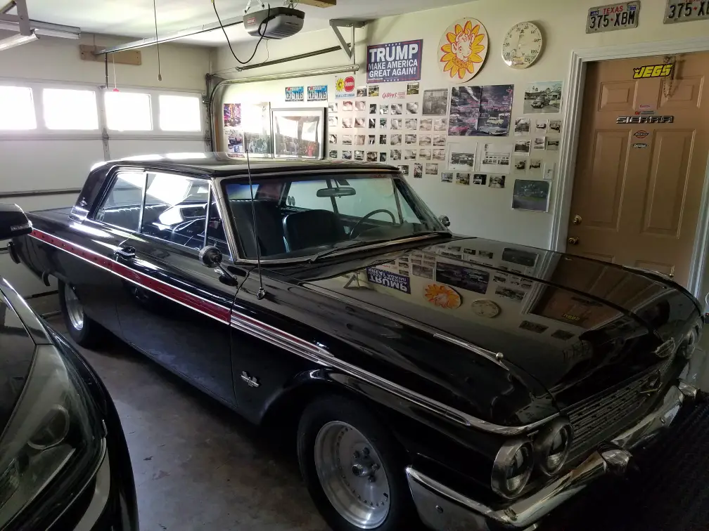

Dad just sent some new pics!
The car looks awesome, Jared. Thanks for sharing the pics. 👍😎👍
Man, having all the trim on makes a world of difference. Just beautiful. Seeing all those years of hard work finally coming to fruition. Wow!!
Dad got the spear on the passenger door and quarter panel. Latest pics....
