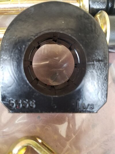

The Energy Suspension bushing kit arrived. They fit the bar but I'm kind of aggravated about the purchase.
I looked up 36mm sway bar bushings on Summit. I know & understand how math works but since they listed both a 1 3/8" option & a 36mm option, I chose the 36mm since that's what the bar size is. The 1 3/8" option = 34.925mm which is 1.075mm difference smaller. While it can fit over the bar & would technically get the job done, the 36mm option should fit the bar better & do it w/less friction than what's required to seat the smaller ID bushing (sway bars should pivot easily).
The box is clearly tagged/labeled as 36mm. Inside the packaging? It's a 1 3/8" bushing.
I already had 1 3/8" ES Poly bushings I could have used if I wanted the increased drag on the pivot point.

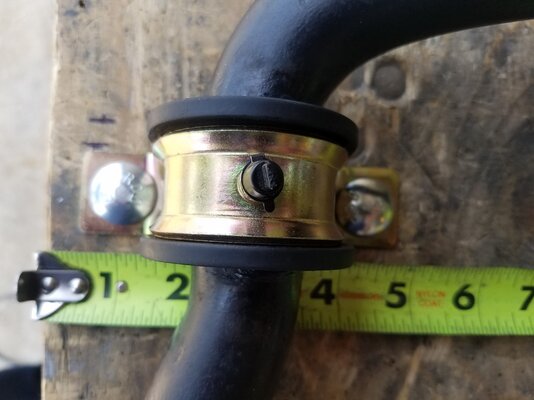

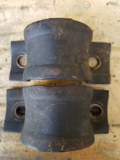

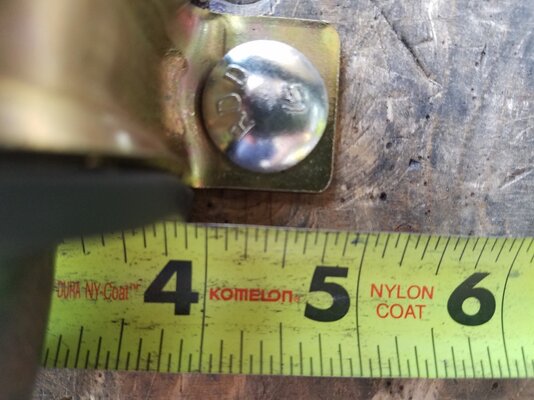

The footprint is definitely larger on these brackets vs. the OE g-body part.....
The OE mounting hardware centerline was ~2.75" on the brackets I have. The ES brackets are ~3 375" on center.
