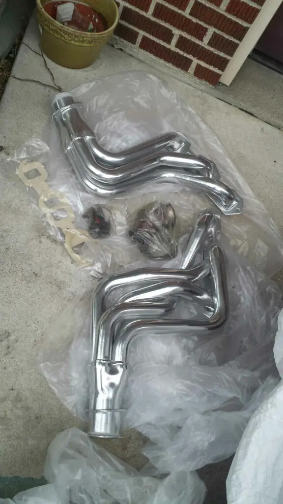

Today I just purchased a set of Dynomax ceramic headers, I forget the dimensions but as soon as they arrive I can post that info. I want to say they were 2 and a little more, but I don't know for sure. I saw them posted on GBF and jumped on them. He only wanted $125, but my total came up to $180 with shipping.
I do know the collector was 3"
Wow I just looked at all the spelling errors sorry. Really I'm not illiterate 🙂 OK the header I bought are aluminunized not ceramic coated. I was going by the box.imagejpeg_0.jpg
Those should be 1 3/4" primary tubes, good for your motor.
