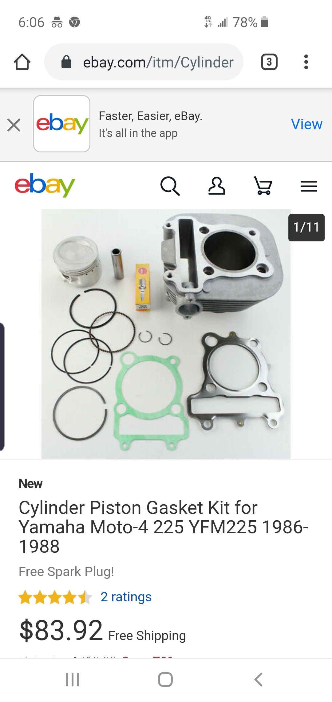

Result? She's hurt -- bad. I was drowning the airbox and it barely wanted to run. I'll assume massive blowby is the culprit at this point. This actual explains a few things, thinking back. I may rig up a catch can of some sort for now but it looks like a top end kit is in my future. I'll pencil it in for the spring.
I'm not 100% sure yet but I think this might do it. View attachment 127907

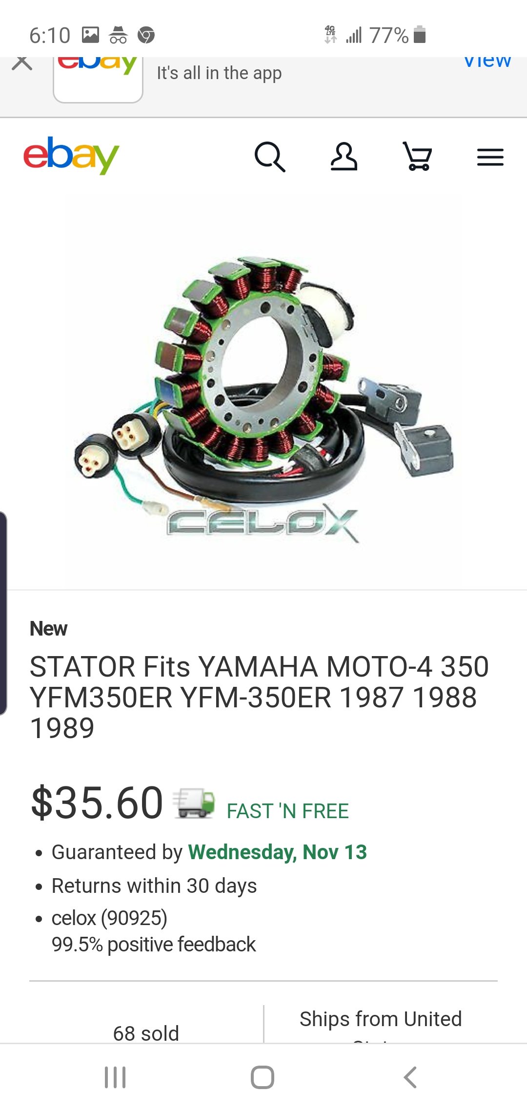

Probably one of these too. View attachment 127909
And I guess I probably should... View attachment 127910
It's only money...and labor.
It might be cheap and oddball, but it does the job, it's yours and you've already done a good bit of sorting on it so I think it makes total sense to fix it.Truthfully, it's probably good money after bad. But it has been a really handy tool so far. Also, the market for 4wheelers around here is pretty inflated so, in that vein, I'm still money ahead to fix it. Used Polaris Rangers start at $6k around here and go up to almost $20k. I'll stick with my cheap junk. I just like this oddball thing.
