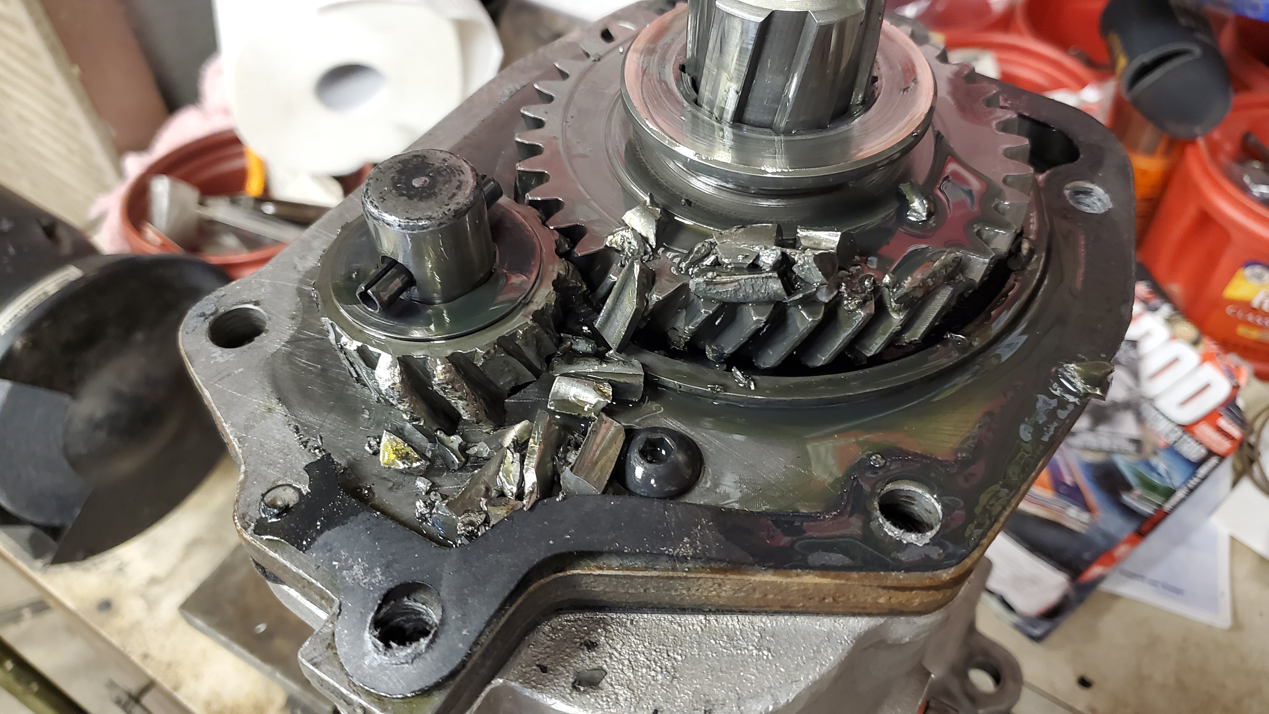

The close ratio Powerglide is out.

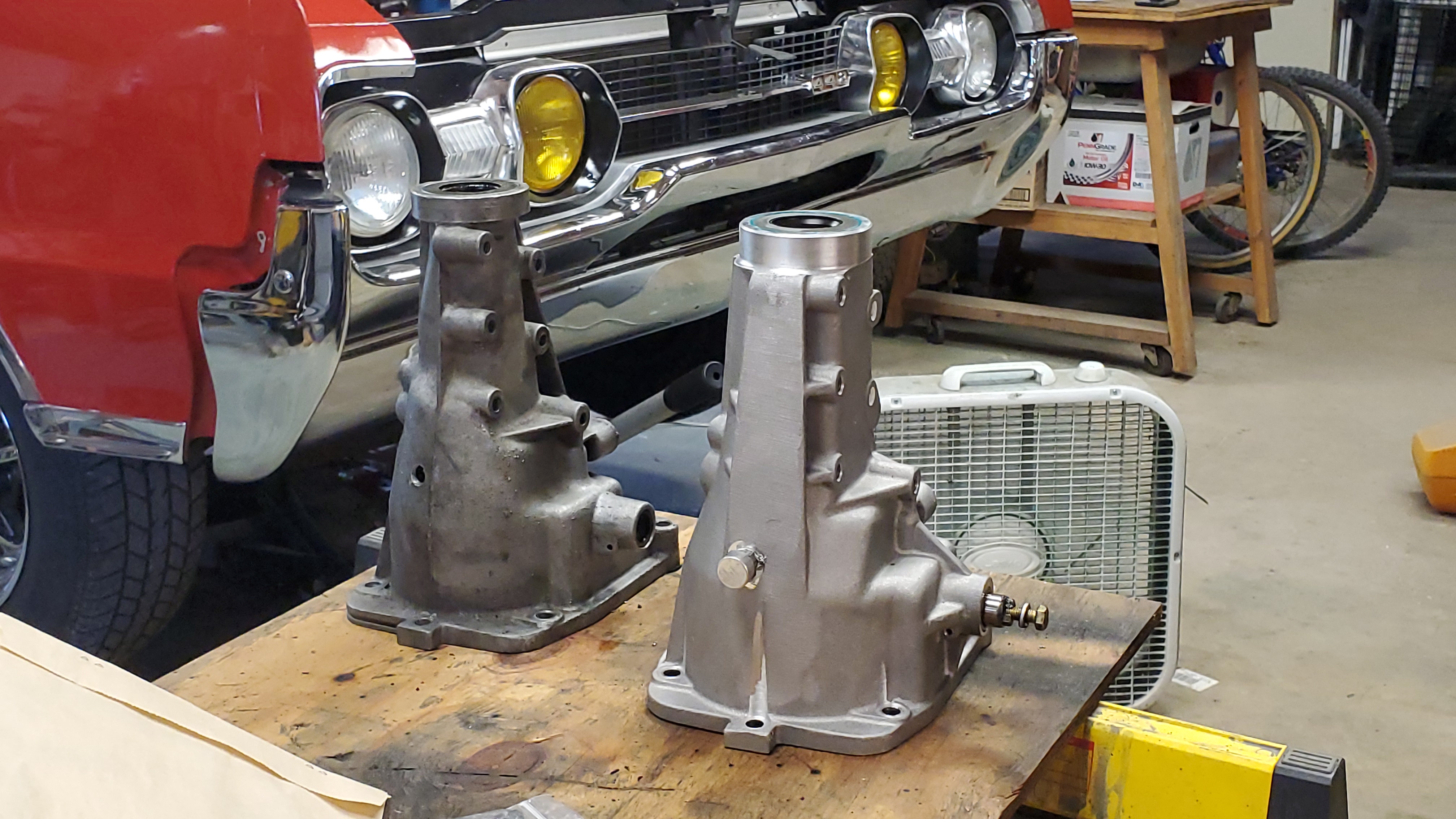

Booger welds are on the other side? Why is the case busted? Still looks better than mine with the busted output shaft sticking out of it.
Yeah, booger welds were on the top above the driver's side rear corner. Didn't appear to be leaking, just not pretty.
Being where it is, I'm guessing it got dropped on the corner and cracked. It won't be my problem.
