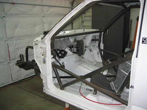

Here is a pic of my current project which might give you some ideas.
Yea idk what Jegs was thinking. Even there drawing shows the bar with a much better angle then what I got. There's a few places close to me that bend tube so it's no big deal but still? What where they trying to do? Not only did it block my view and give me zero hand room but there's no way to fit a dash bar like that and it look good. I mocked it up and the new bars will look good and fit tight. Your truck looks good. Next cage I'll be bending myself.
