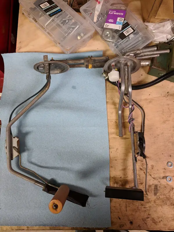

I am new to this and I am trying to determine the best way to resolve my fuel tank/supply needs.
I am putting a 4.8L in a 1980 Cutlass Cruiser Wagon. It is carbed currently. Trying to be as budget friendly as possible.
Does anyone sell a sending unit that will fit the stock tank that will accept an in tank EFI pump?
Should I sump my stock tank?
Should I run a sumped cell with external pump
Should I switch to a GN Tank, sender and in tank pump?
You need a 92ish 4.3 astro van fuel sender which almost is a direct fit and reuses your stock tank. Wagon stock left astro right.
You need to cut off the clocking tabs and it drops in. No sumping, no special tanks, works well.
Good,. I bought one yesterday. Question: If you cut off the clocking tabs will it still lock in the tank? It's been a Long time since i've fooled with a sending unit and I cannot remember
