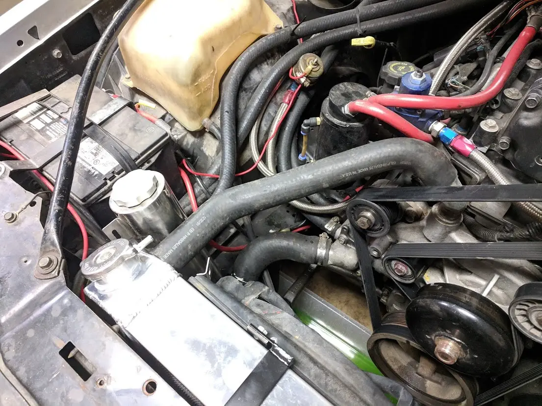

For those using a dual pass, both inlets on the passenger side with a pickup water pump. I used the griffin 31*19 radiator.
Lower hose- 88ish e150 ford van with the 300 I6
Top hose- G body 3.8 buick v6 hose with about 6" cut off each side.

Decent! I just did this last week, but with an LS1 water pump. I might change the lower hose, but for now it's good...
