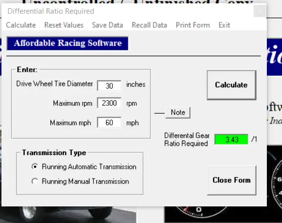

Who would run tires that 30" or 32" size in a G body? The OP has a .70 overdrive and 4.8 LS, I say 3.42 minimum, probably 3.73 considering the 4.8 likes and needs to rev. I use the Olds Gmail calculator when using a lock up torque converter or manual transmission, I add 300ish rpm for no lock up with that calculator. With a 28" tall tire, my 2.78 gear and the current non lock up TH350, 60 mph is that 2300 rpm for me, a 3.42 would be around 2800 rpm at 60 mph. http://tech.oldsgmail.com/ch_axle.php
Being that the stock 4.8L isnt exactly considered a performance engine(285hp), and with the 4L60E OD transmission used, its more of a daily driver of sorts with gas mileage in mind, i would go with 3.42 max if you want some pep moving from light to light, along with an average of a 27" tall tire, you'll be keeing the engine around 1800rpm at 60mph, around 2100rpm at 70mph.
