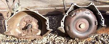

Chev on the left BOP on the right
are those suppose to be 200-4r transmission's or just representations of chevy and bop?
the reason i ask is i've had 4 200-4r transmission's and all were multi fit bell housings. i have never seen a chevy only 200-4r. but everyone says they exist.
