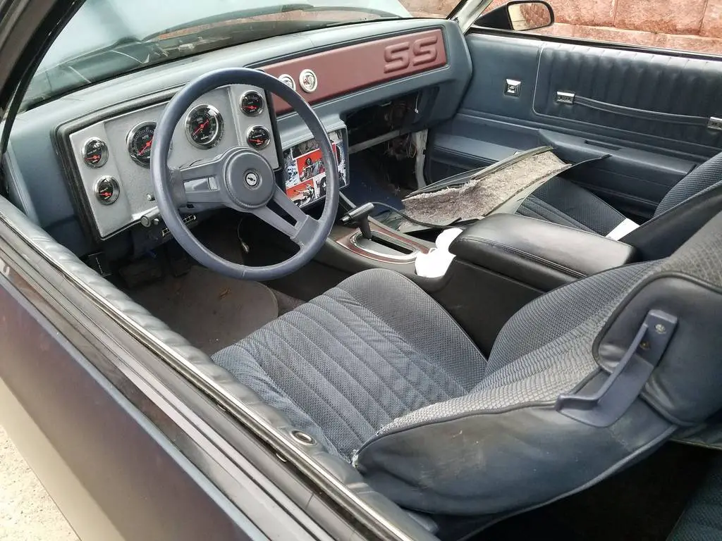

Here's some inspiration, the Monte when I got it and what I turned it into. Honestly it was the first time I ever messed with an interior other than switching out panels in my GTO to go from OEM black to blue. Taking the dash out and following some of the YouTube videos will get you further than you think.
View attachment 197688View attachment 197687
In my best Owen Wilson voice wow
