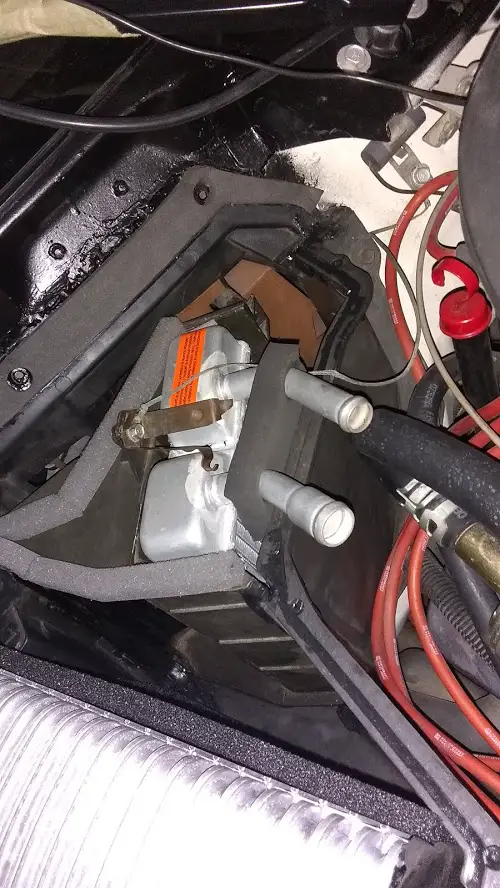

The original h

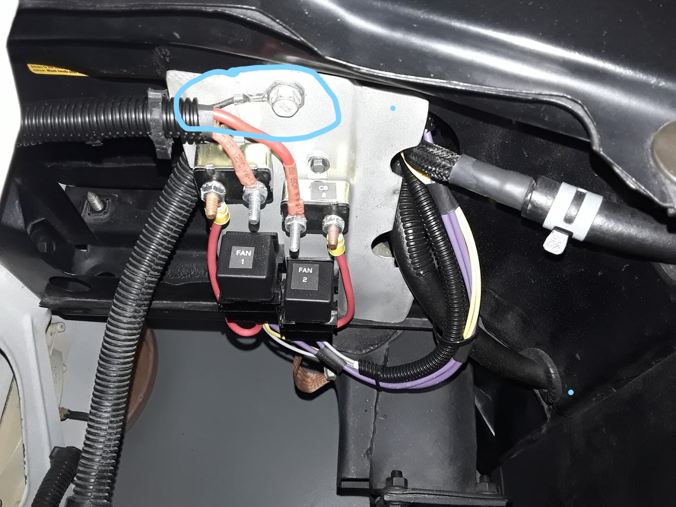

eater copper core had a ground wire to the firewall. When I replaced the core I reinstalled the ground wire to the aluminum replacement core. The radiator sits on four (4) rubber pads . If it needed to have a ground then GM would have put one. If it makes you feel good, ground it to the radiator header. The light harness is grounded there.

View attachment 234666 The original h View attachment 234670 eater copper core had a ground wire to the firewall. When I replaced the core I reinstalled the ground wire to the aluminum replacement core. The radiator sits on four (4) rubber pads . If it needed to have a ground then GM would have put one. If it makes you feel good, ground it to the radiator header. The light harness is grounded there.
Do not ground the radiator or heater core. Back in the late 90's, I worked at a Chevy dealer. I put 2 heater cores in a Monte Carlo. They would last less than a year. I called GM Technical Assistance and was told to install a ground wire on the core which I did. A week or so later, the Service Manager gets a call from Technical Assistance and they want the customer to bring the car back to remove the ground wire. Apparently, the ground wire is old technology for brass heater cores. I was told to use a volt meter from battery + to the coolant in the radiator. IIRC, .1 of a volt was max. If it was higher than that, it meant that the coolant could be old and acidic or there was a bad ground on the car which was causing current flow through the radiator or heater core. I had to turn on everything on the car to make sure that no component had a bad ground. I actually found corroded grounds at the transmission. It never came back for a leaking heater core. So don't ground an aluminum radiator or heater core.
