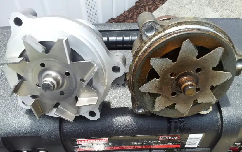

Here's a picture.

Here's a picture.
I put mine in place of drain. On Becool radiator it is on pass side bottom of tank. Wondering if it will hinder flow on outlet or deteriorate faster because it is in direct flow? 🤔
