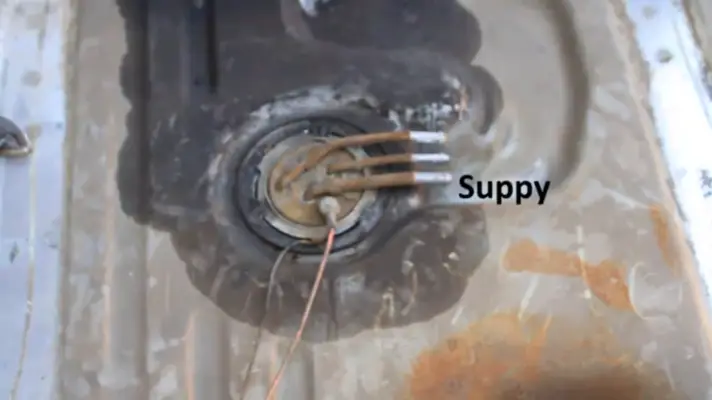

Is there anything I'm missing that can cause high fuel pressure using new Spectra fuel sender, external fuel pump, and Corvette filter/regulator? I'm pretty sure my lines are correct. 3 line sender (supply on left, vent in middle, and return on right). After some other issues an open injector was causing iDo get 58ish psi at idle, but when my tuner was tuning the car iSaw it go to 80 and 100 psi (may have been during revs iCant remember). Car was not in gear, just sitting on jack stands. iBought another regulator, but iSaw something about a restriction with the Spectra fuel sending unit? I looked around for the right diagram for the sender. What iFound had the lines wrong to me (link below) bc it showed the supply on the left (3/8), return in the middle (1/4), and vent on the right (5/16). I'm really curious about that in tank restriction comment iSaw. The person who asked never got a response and I've seen someone else bring that up before.
Here's the YouTube link iScreenshot the sender unit from:

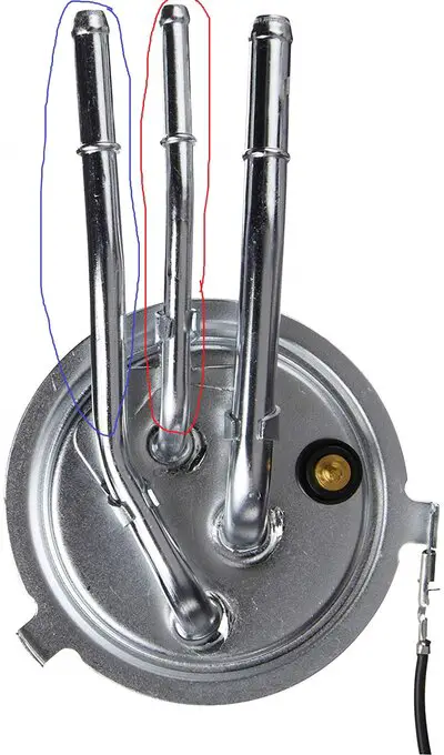

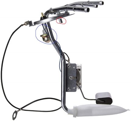

See how the middle connection is open at the top of the tank (red), and the right connection has whatever that is attached at the top (blue).
