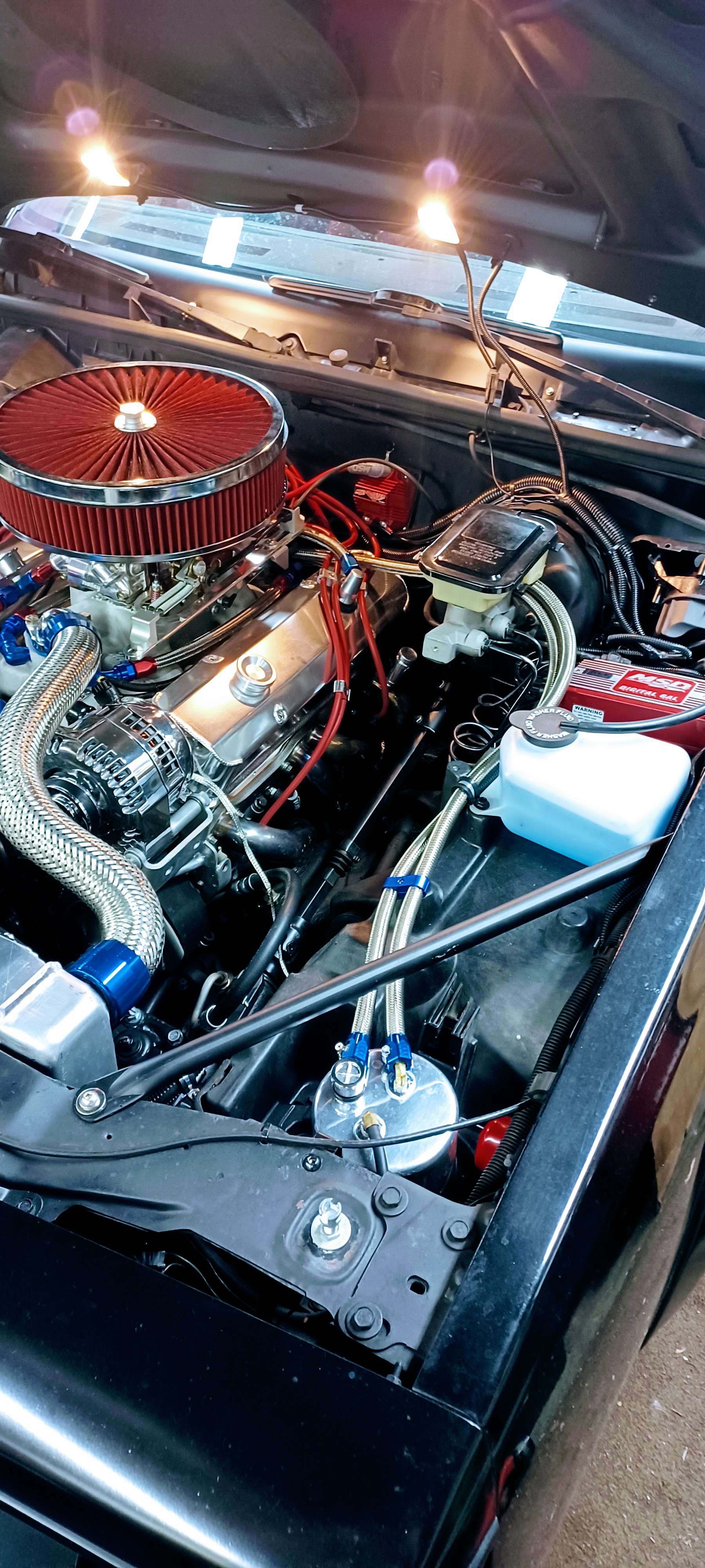

I made all of the braces on my Monte and the fender to core support, GP bar and rear brace for the Regal.
The fender to core support braces I used 3/4" EMT and made a crimper for my press to make a nice end on it.
The jounce and GP bars I made out of Rigid 3/4" EMT which is about twice as thick as the factory bars and I bent those in my HF tubing bender and also crimped the ends.
And for the rear bars I used 1-3/4" roll bar tubing with my Monte's being welded in and my Regal's I made as a bolt in.View attachment 243979
Very nice job on crimping the ends. That detail make them look like a manufactured product. I think most would just squash the ends flat in press or vice and call it a day.
