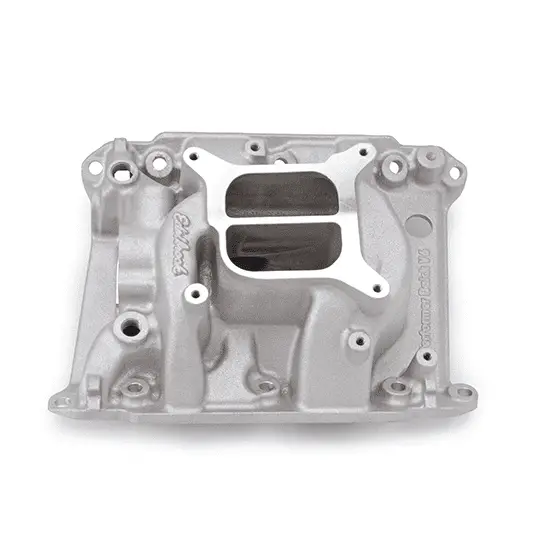

If this is your current intake I will bet that it perform better than the Holley you posted
It is a true dual plane since the divider is not cut down like the Holley and it is a square bore carb bolt pattern like your 390 instead of a spreadbore design with dual bolt pattern.
