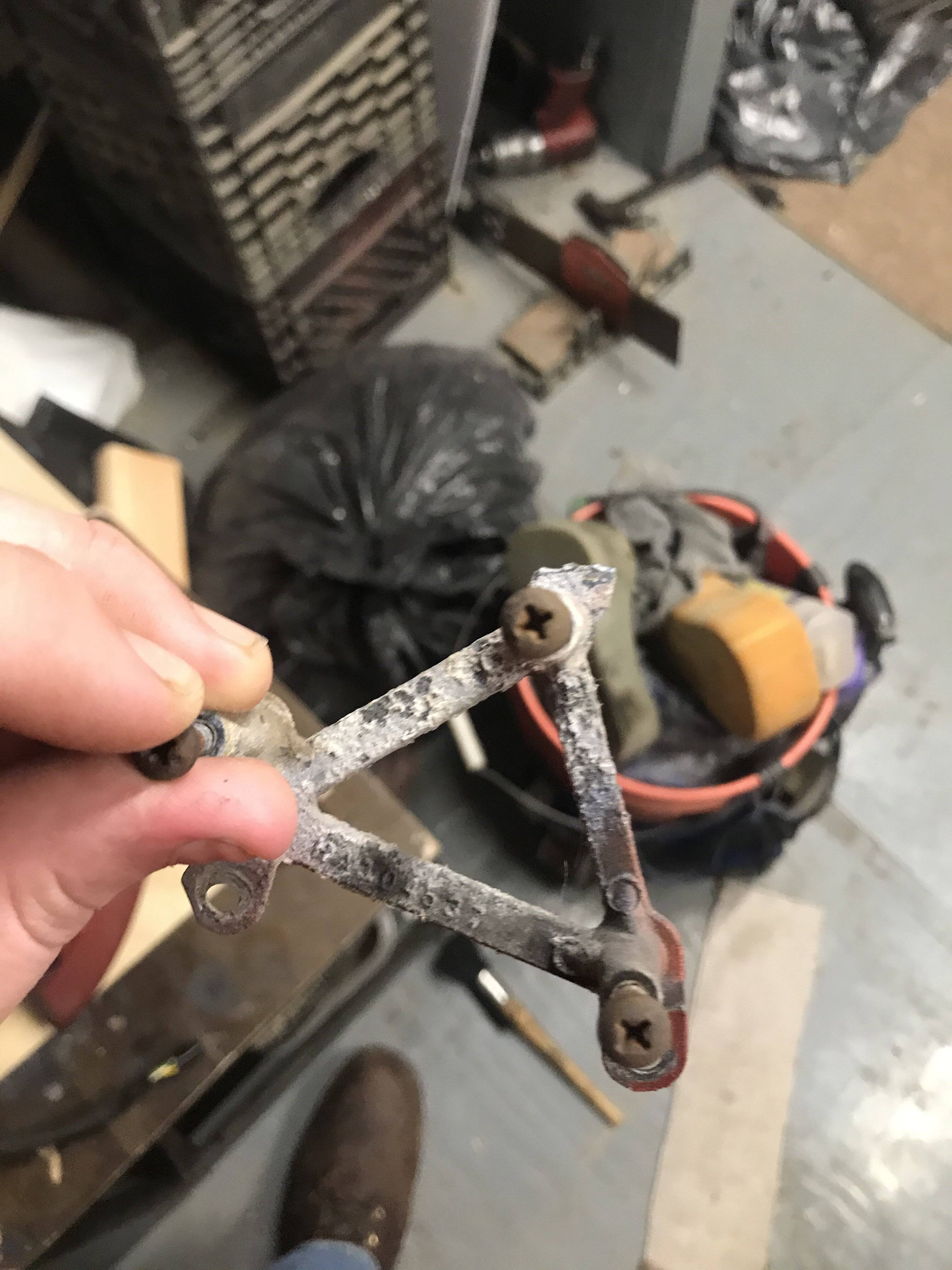

And while I’m here, anyone know where I can snag another one of these brackets from?
This is out of an aero mirror from a Trans Am with power side mirrors (motor works) and the upper tab just corroded off, it’s basically white sand at this point so I can’t even glue it back on with metal glue.

Driver side?,or passenger side?
I might have one extra. I forget which side it came from, although it would be easy to check, my mirrors are still disassembled.
