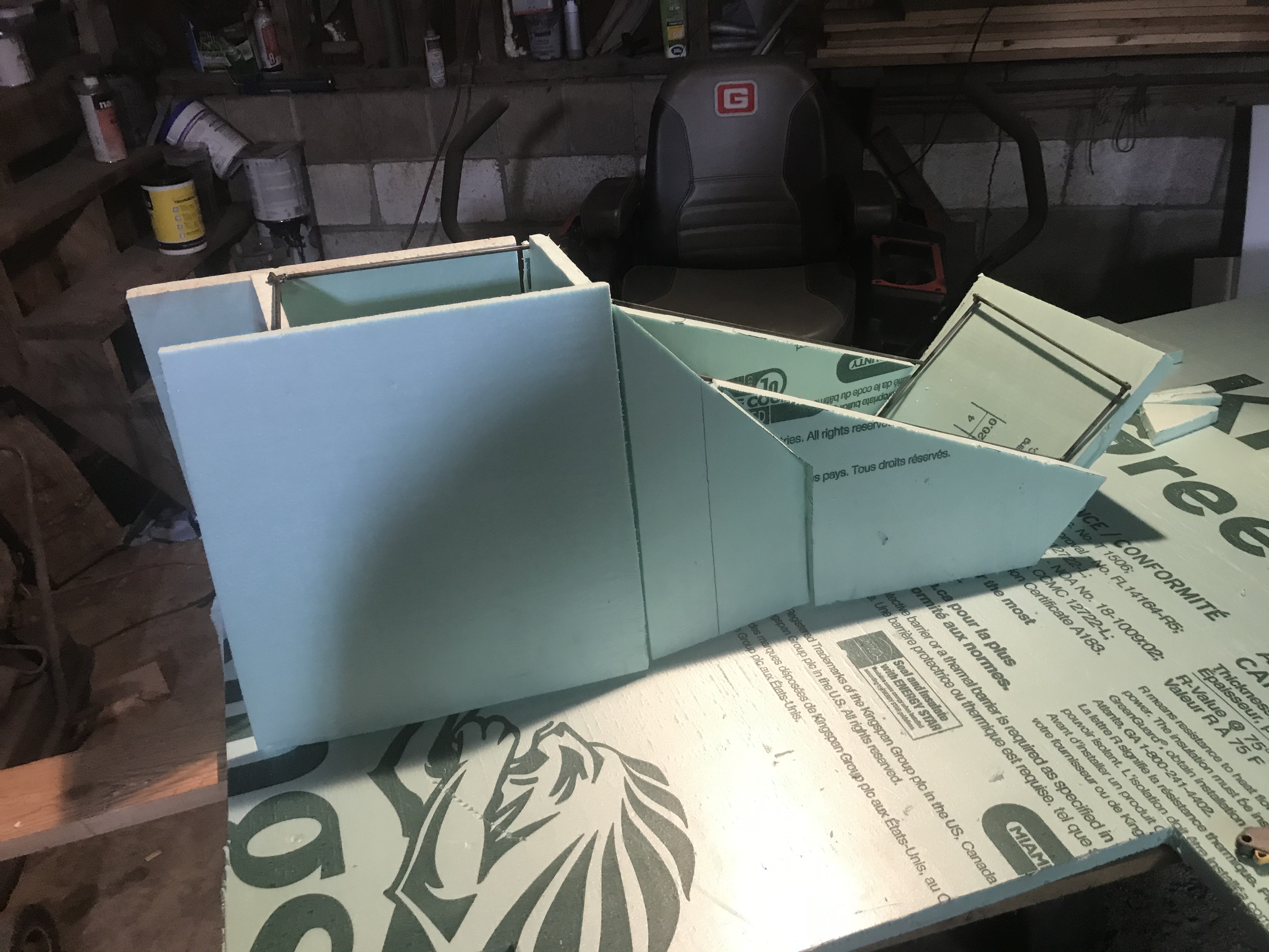

A little sneak peek of a console I’m working on, it’s an absolute monolith.
Might change that, it’s this tall to have a comfortable arm rest height while driving.

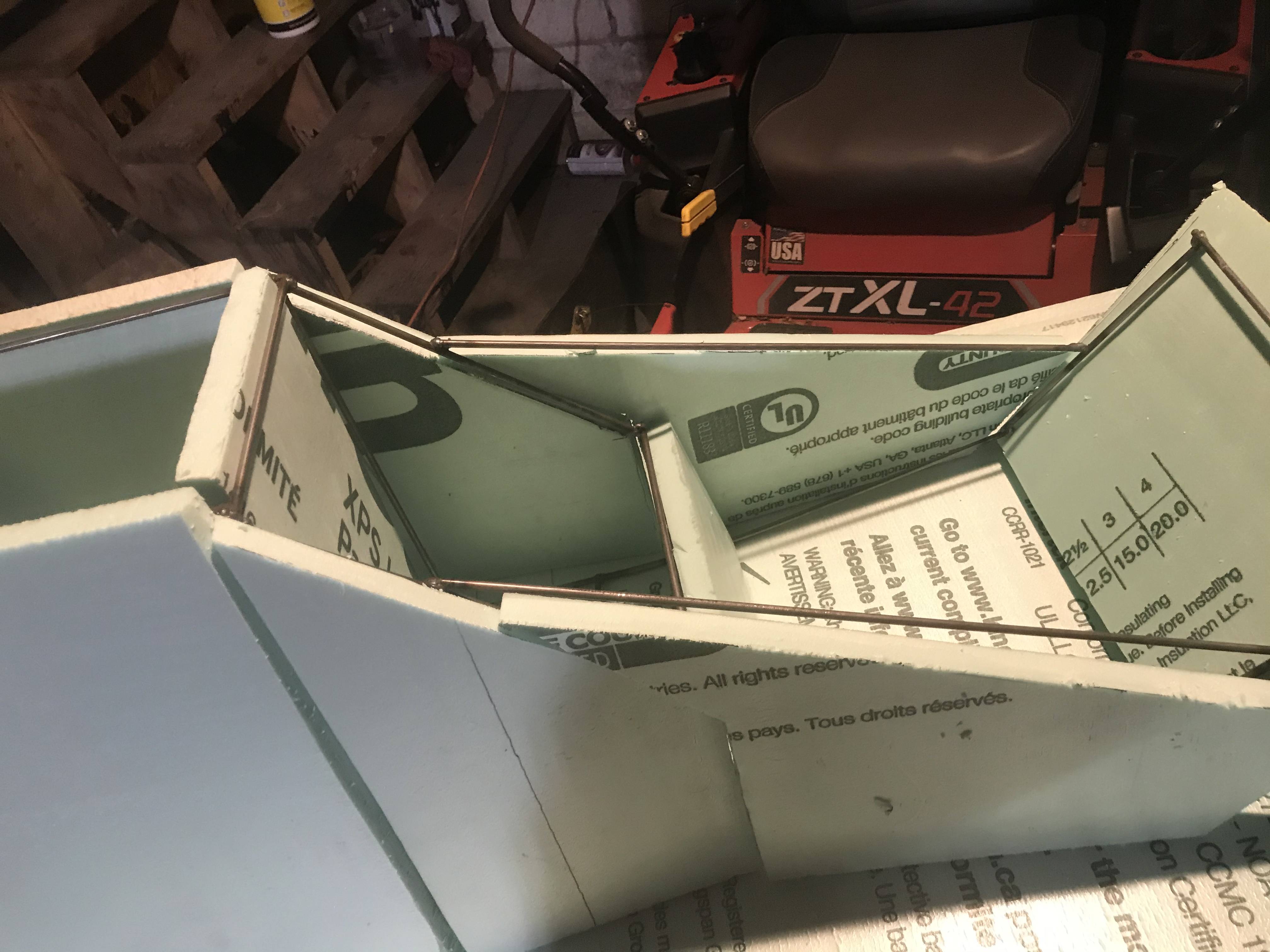

Small update on this, I finished it but have decided to build another one from scratch. While this console (sort of) worked I made a few mistakes when I built it, chief amongst them the height of it. I ended up trimming it down and with an armrest it was still too high and after fiddling with it all winter I came to dislike the used Z-Gate I had for the car. I felt it was a bit too clunky for what I was using it for since I went with a forward manual shift kit in the transmission, and the Z-Gate requires a T-handle to be pulled up for every downshift. That got annoying really fast.
I managed to find a Quarter Stick at Canfield for cheap enough and I’ve gotten it modified and mounted in the car. And since it’s around 4 inches or so shorter than a Z-Gate, I need a new console anyway. Hopefully this time I’ll find space for cup holders.
