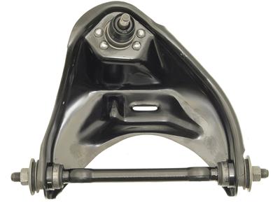

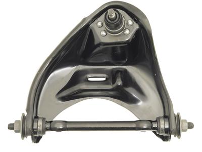

I spent some more time looking into control arms. So Moog has two different lines of control arms, the CKs which are the "better" problem solvers, and the RKs which are a cheap budget line.
For our cars and the S10s, the better CKs are discontinued and any that are still available are old inventory. So basically I'm stuck going with the crappy RK control arms if I want the new Moogs. sh*t. I'm not liking my options here.

I bought a set of AllStar lowers for the Cutlass
For my Regal I just bought these fully loaded uppers to get the car on the road instead of wasting my time blasting and rebuilding my rusty originals.
If I decide later on I want to upgrade I don't have a lot invested in these and can probably sell them when removed.
The lowers I found new also but they were bare so I bought bushings and balljoints from Rockauto.
The car aligned fine and drives fine so this fit the budget build plan for the Regal for the time being.

What is wrong with old inventory?
