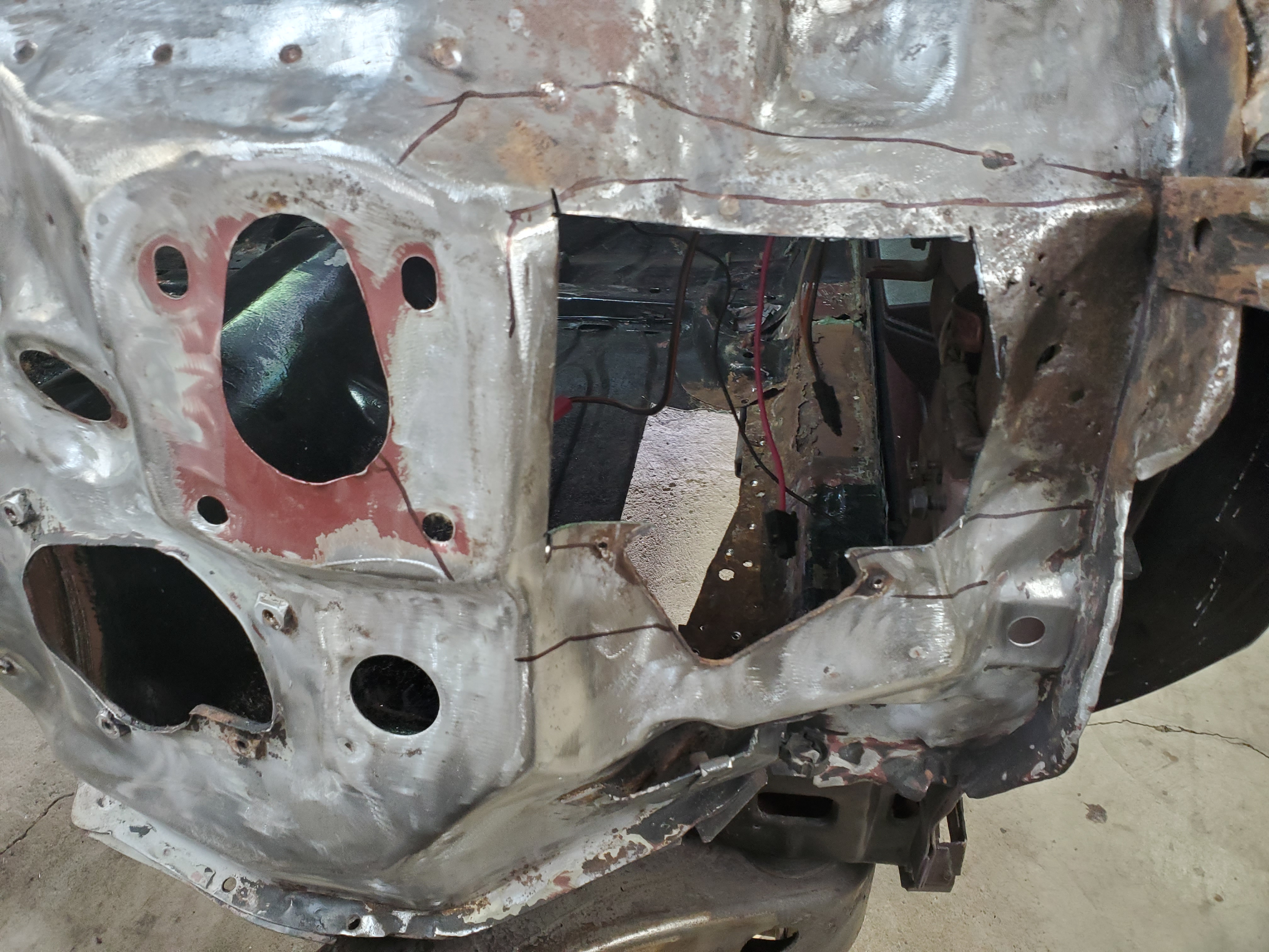

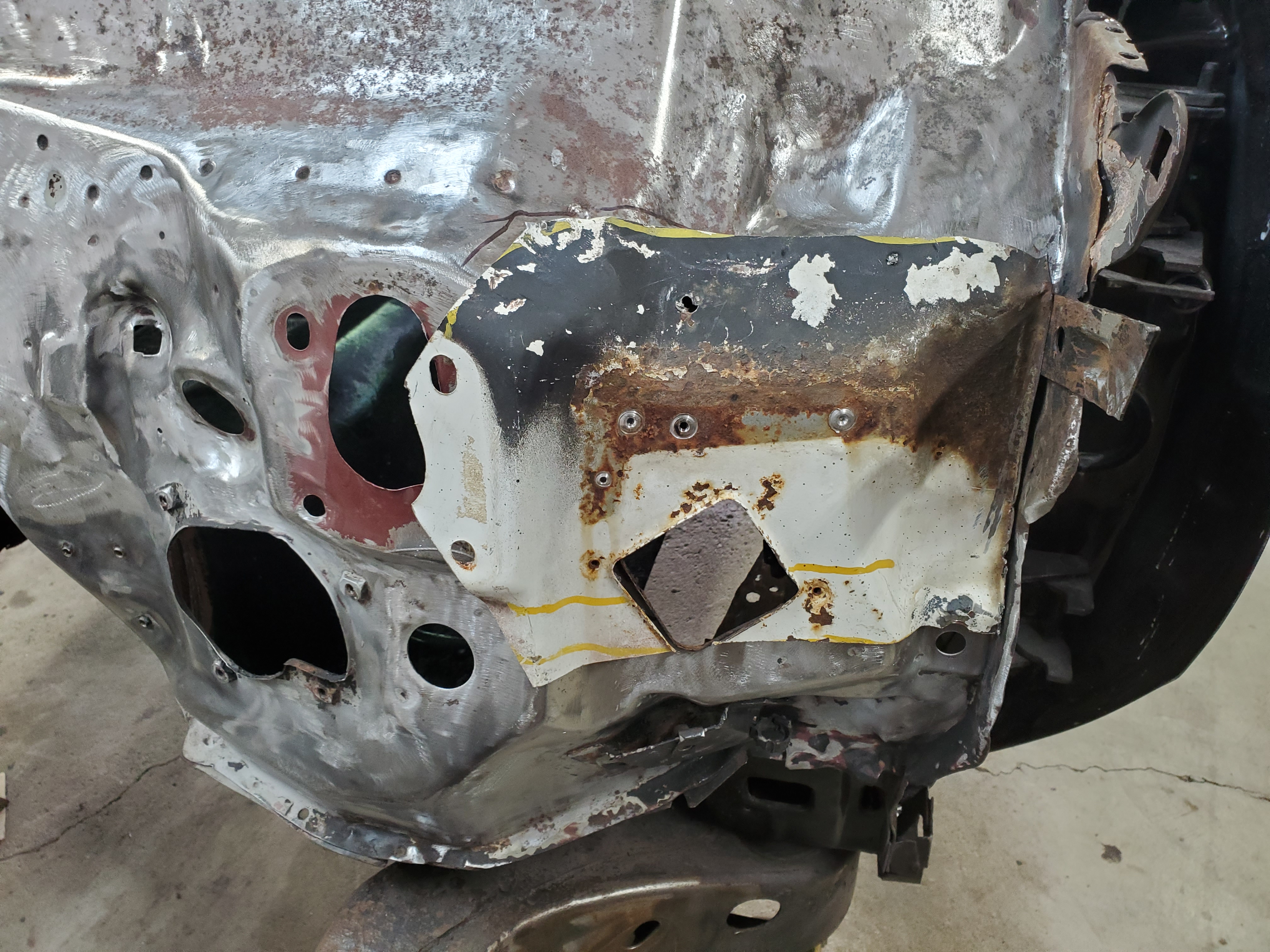

Last thing I was working on was patch panels for the floor and the firewall. So I took the firewall patch panel I got and drilled the spot welds, separated it into the individual pieces of metal. I got it trimmed to a general shape and I cut out a section of the rust in the firewall. The patch needs to be made smaller and i need to cut more out of the firewall, but it's a start and more than I thought I'd do today.

View attachment 148984View attachment 148986
