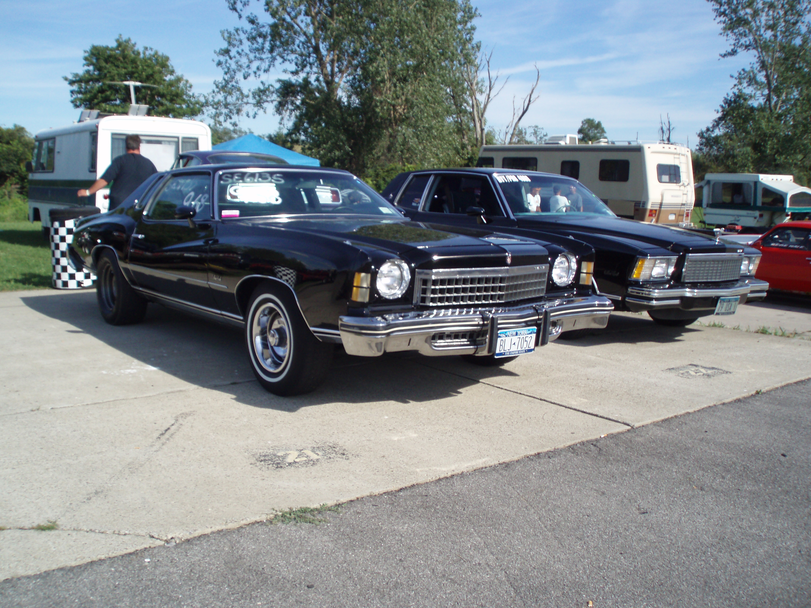

I'm partial to the 78/79 nose, They seem to have the same styling which started with the 1st generation.
Parked next to my brothers 74 Monte Carlo you can see how the style is the same yet different.
2nd and 3rd gens pictured,don't forget the 70-72 are the 1st gen😉
Parked next to my brothers 74 Monte Carlo you can see how the style is the same yet different.View attachment 59136
