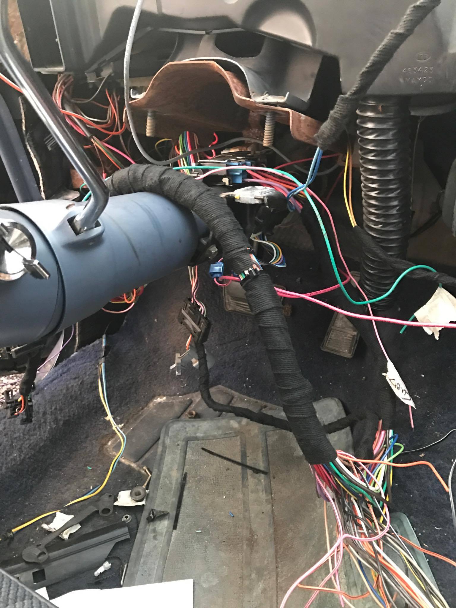

This is the TESSA tape u can see where i wrapped it already obviously... this stuff is awesome ! need to order more

If that is the stuff the the OE's use, it's pretty good.I hated that stuff when I worked at the junk yard. It sticks good. Aggravating to remove. It should hold up pretty well.
