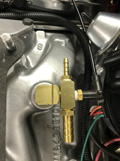

That vacuum fitting was also a pain in the butt. Not that it was hard to do but I gave my drill press to one of my friends 5 or 6 years ago so I had to search around for someone that could let me use theirs. LOL

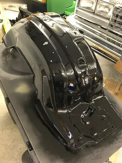

I also spent a good part of yesterday cleaning and prepping the left side inner fender for paint. I had a small crack to fix at the bottom of the back side. It was about
2 1/2" long. Didnt know how it would work but I used Permatex Plastic Bond. Gotta say it worked really well. Cant even see where it was.
So this morning I sprayed it with Bulldog, DP primer reduced with a little DT as a sealer and just followed with two coats of SEM Hot Rod Black. Looks pretty good. By tomorrow afternoon it should be a lot less glossy.

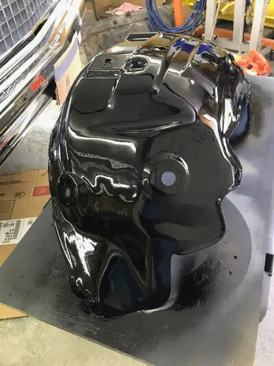

That inner fender in the photo never flattened out for some reason. Im not sure why. Ive sprayed gallons of the SEM Hot Rod black and the results have always been the same. A nice semi gloss. Maybe the primer wasnt cured enough. Maybe it was too cold when I sprayed it. I have no idea. I had another inner that was for the 81 that was already to go so I figured I'll that one instead.

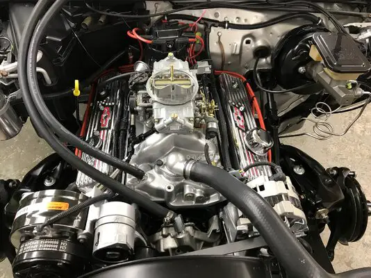

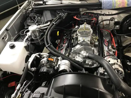

Gettin down to the end.
Im ordering a couple of cables tomorrow from CE Auto Supply. A negative cable to replace the one I stole from the 81 and the cable for the alternator/battery. Gotta put in some antifreeze and it can be started. FINALLY. I still have to put the left side inner fender in but Im waiting until the motors running and timed. I still have to trim the plug wires at the cap and theres a couple of wires that still have to be put into the bulkhead connector. Figure its easier with it out.
Lots of hoses and wires though. A friend of mine that owns a shop said he can charge the AC for me. Hopefully he can bring the stuff over to my garage to do it since it usually takes a 40 point turn to get a vehicle of any size into his shop due to the collection of junk hes got behind it. I still have to get an exhaust done. Not sure if Im going to buy a kit like Pypes or have another guy that I know bend and weld something up at his shop. Ive seen some of his work and he does a nice job with SS.
ALMOST !!!!
