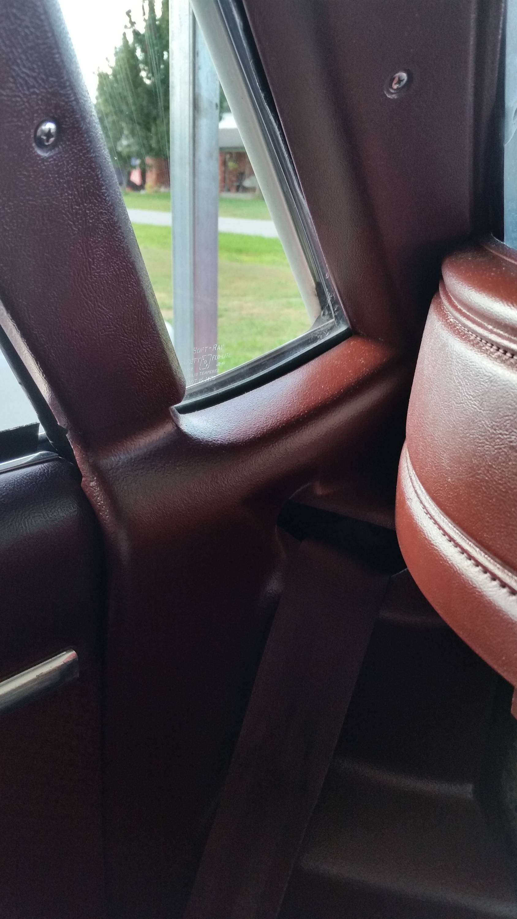

Here's the rear panels that were sun damaged. After bed liner and SEM paint over the top. It would look better to sand with 400 before putting on the interior color. It would make the graining look more factory.

that thing is lookin sweet! never heard of using the bedliner spray to redo the panel graining, but a way cool way to re-use original panels!
Wow. That looks like a decent solution to this common problem. "Reproduction companies HATE it when you use this simple trick..."
What brand of bedliner did you use, and how did you apply it?
